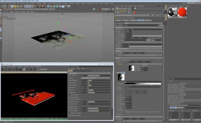

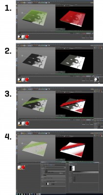

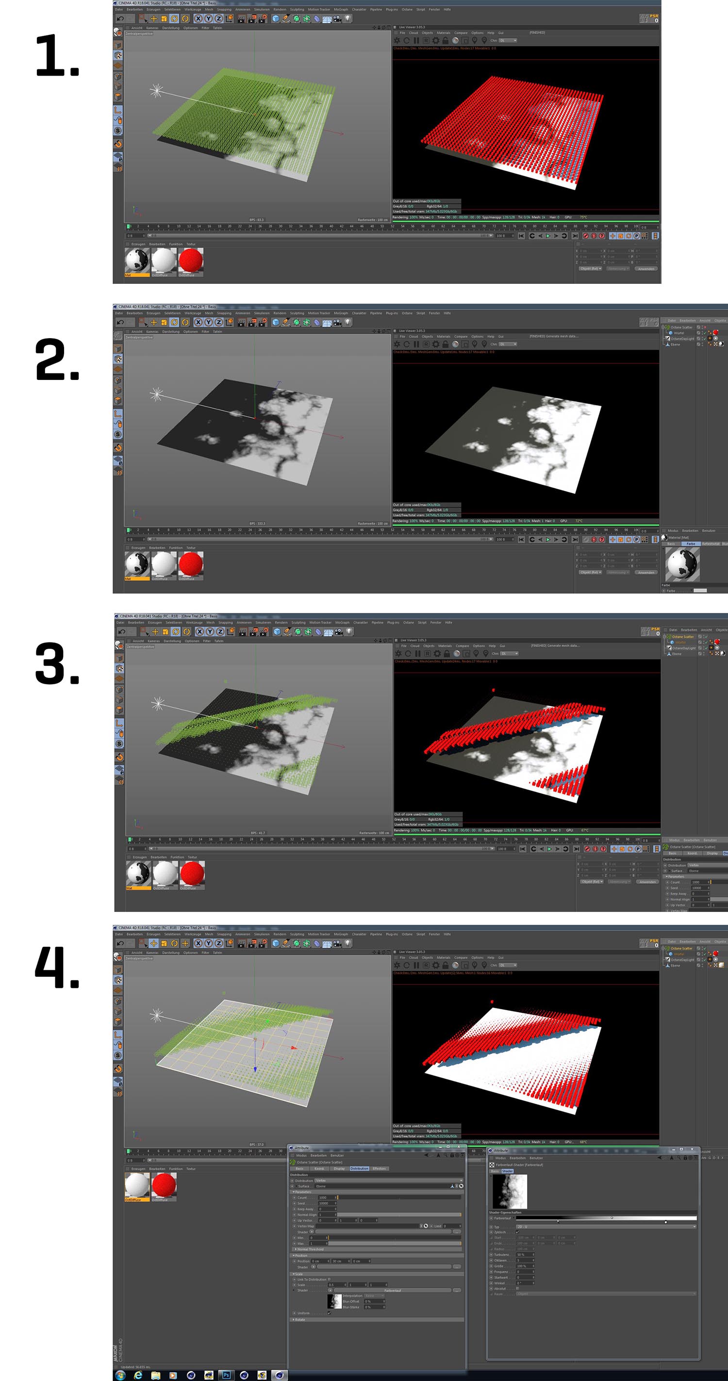

Hi there, here comes a other description of my problem. 1. I placed a cube under a scatter object and use a plane to scatter onto. 2. Now I used a gradient with some turbulence in the scale channel of the scatter object. 3. What happens is not what I wished to get. 4. In this picture you can see the gradient and how it is placed in the channel. Why is it turned 45 degrees and world y axis and 90 degrees un x axis and why is it repeated two times.
Best regards
Max

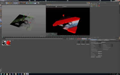

Hi Harzer,
please, try with the attached scene:
gradientScatter.7z
(92.48 KiB) Downloaded 139 times
ciao beppe
