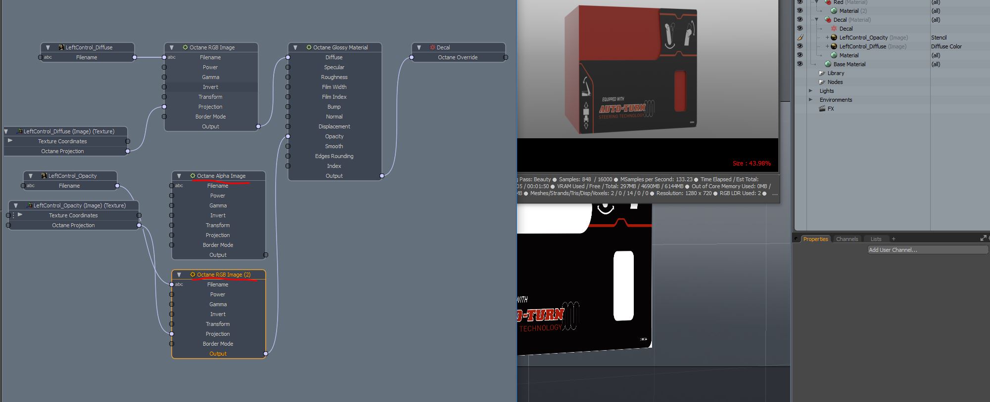

When I bring in a JPEG, and I have to use it as an Opacity map, or Stencil in modo terms, it wont convert on the fly. Is there a reason for this? Am I using the wrong image format or something?
So what I have to do is convert it to an octane override, then it puts the correct map in the opacity slot, but its an alpha image, then it doesn't work. If I make a RGB image, then just reapply the exact same pins, it works.
Am I doing something wrong? Would be great to be done with Octane overrides!

Can you provide a screenshot of the shader tree and the stencil image settings pls?

Can you send me the scene and image pls?
Paul
Paul
You bet. Here you go.

Your stencil is a JPG - which the Octane plugin assumes does not have an Alpha channel. But you have Alpha Channel = Use for that image. So change Alpha Channel to Ignore, and it works.
