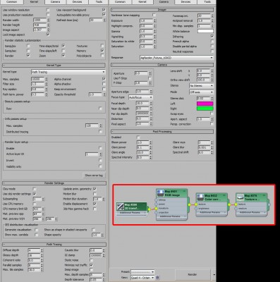

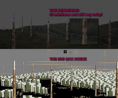

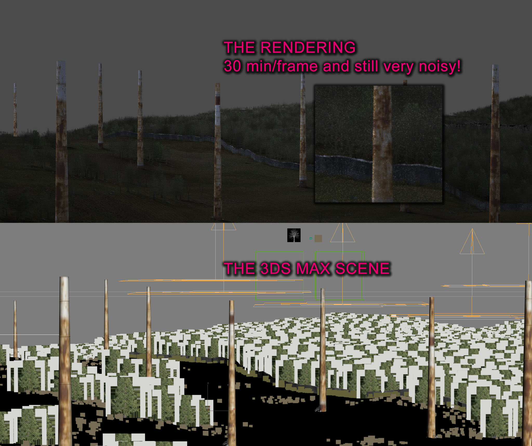

I'm rendering an landscape animation but my rendertime are very long (more than 30 min/frame) and the result is very noisy.
Rendertimes are very important (more than 30mn!!!) and still very noisy
but the scene is quit simple :
- a ground (no displacement)
- a few bitmap sprites particle for the trees
- HDRI (512x256 pixel) environnement for the lighting
and that's all.
Any advice about how to decrease render-time and get rid of the noise?
Tahnks
Octane 3.03.4 - 4.21
Max 2014
Win7 pro
RAM 24 Mo
GTX 980ti
GTX 780
Long render time + lot of noise
Using alphas for vegetation is really compute intesive. You will get faster results using "real" instanced geometry with moveable proxies.

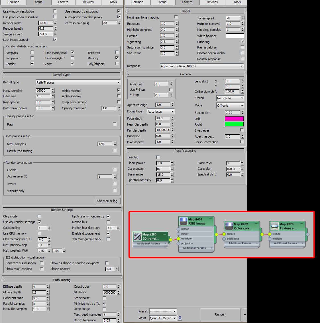

maybe share your settings here so we can take a look

Hi Fabrice,
You probably are not using imp. Sampling or you modified the evironement mapping transformation and this generates noise issue.
viewtopic.php?f=80&t=60992&p=312417#p312377

Ok, go to Path Tracing tab -> GI and change '1000000' to '2'. After that go to Kernel settings -> Max samples and change it from 16000 to 500-1000.

Thanks Promity!
but with GI clamp set to 2 instead of 1000000 :
- rendertime is extremely shorten (cool)
- BUT no more light seems to be entering the scene. There is allmost no more bright zone on the objects. I'll try some higher values...
