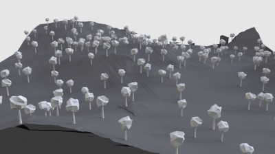

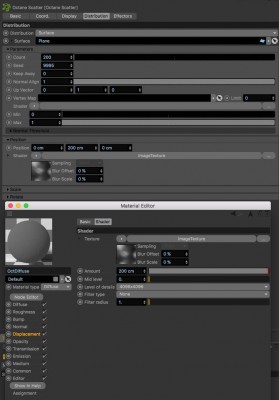

I put the same texture from the displacer in the shader channel of the Scatter position....
mid level of the displacer has to be 0
this works, great!
(I only don't get the right normal direction...)
By the way is there a trick to get rid of the strange borders?
Thanks, Andreas.

It works... but you have to make sure the color profile is set to linear, otherwise the objects do not line up with the displaced surface correctly. Thanks for pointing me to the right direction!
As for the edge artifacts, just resize your displacement map to 1.002 and they should disappear.

Don't put displacement but texture that's connected to displacement. And ply with translate.y parameter.
