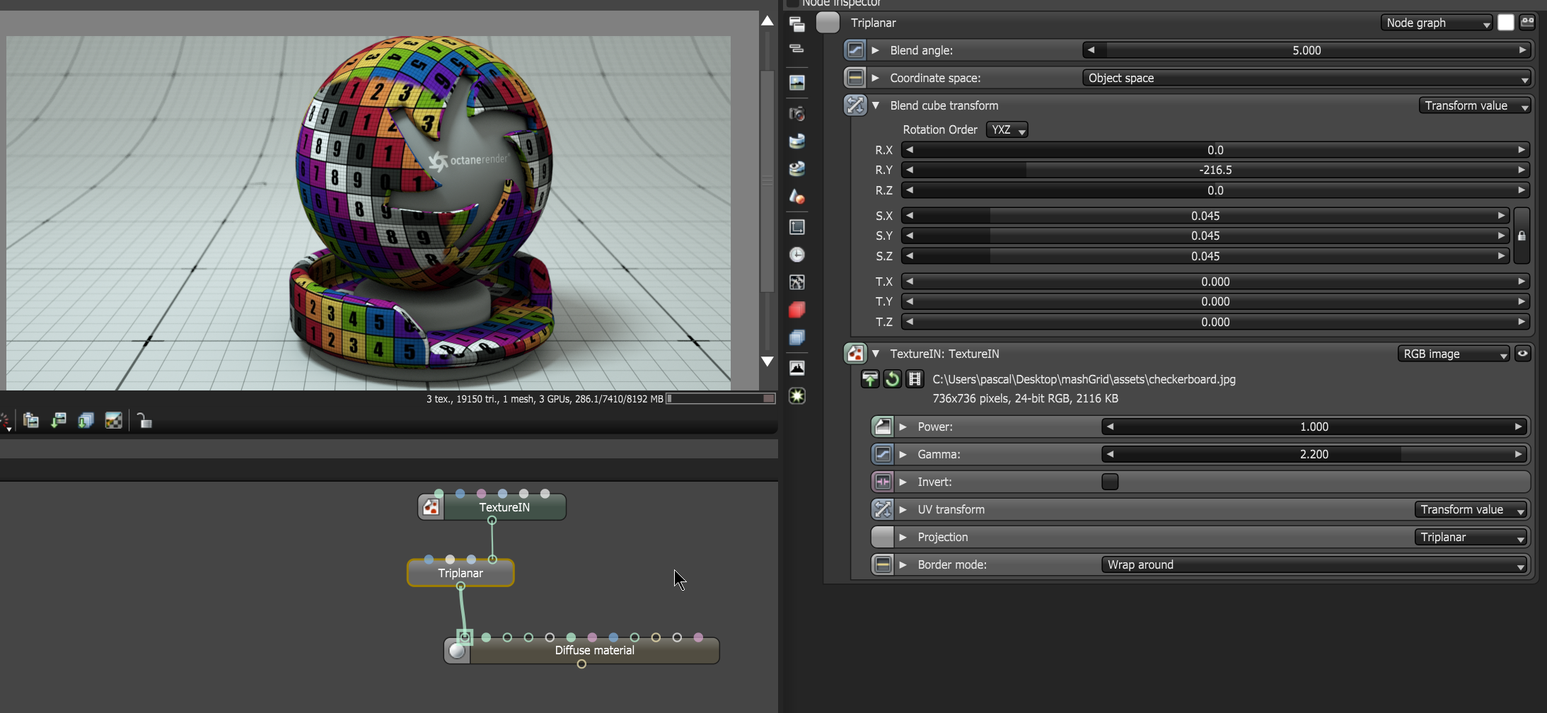

It sounds like you didn't notice that textures using the Triplanar projection should be used with the Triplanar Map node.
Triplanar Map node do all that, extra blending, one texture input can be connected to the 6 entry and works with no further projection setup, post transform of the textures and the blending box at the same time ....
But anyway for an even simpler Box-like setup, here is a group node with only one input for one texture using a triplanar projection and one output to plug to material,
you could just save this node in localDB and use it when needed, also you can find this node in Live DB Texture as I saved it there by mistake haha.

Is there any way to do this in the c4d plugin? i don't see a triplanar projection type so I'm stuck setting projection on each side

waltondt wrote:Is there any way to do this in the c4d plugin? i don't see a triplanar projection type so I'm stuck setting projection on each side
Oh right, the triplanar projection seems to be missing in C4d.
So you would have to ask Aoktar to add it...
