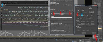

How can i set up the frame range of an "abc" ?
I need to synchronize differents "abc" and all of them are imported at 0 frame.
attached screenshot
Regards
Paride
