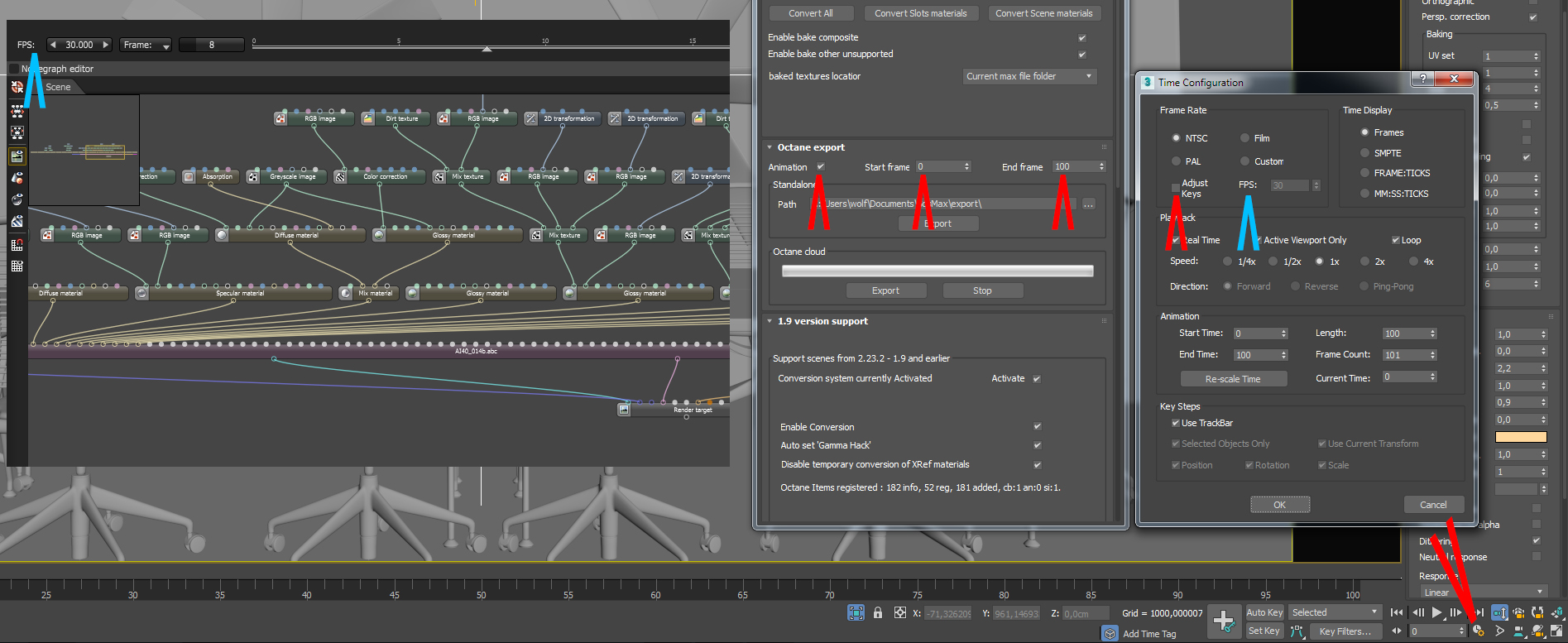

How can i set up the frame range of an "abc" ?
I need to synchronize differents "abc" and all of them are imported at 0 frame.
attached screenshot
Regards
Paride

About abc sync, i meant sync into standalone. I already exported my animations from max.
I will precise you the situation.
first, i export my car animation of my full timeline (all my sequence, it contains numbers of different takes. // frames from 0 to 600)
Then, i export my cameras animations ( only frames from 100 to 160 for example)
I import car animation into standalone, the frame range is beginning to frame 0 (everything is normal), but the cameras are also imported to the frame 0 and not from frame 100 to 160.
How can i resync abc containing my camera, please ?
Do i need to export camera from 0 to 160 to synchronize it or is there any other issue to time offset them ? (saddly, this solution is not good in every case and force me to export hundreds of unusefull frames of hundreds of meshes)
Thanks again ;).
G.
paride4331
Posts: 4004
Hi finkaboutit,
unfortunately it is not possible to export .abc from 100 to 160 because there is not a parameter "start from..." in .abc file.
the workaround is to export your animated camera from frame 0 to 600 and then render it from 100 to 160.
Regards
Paride
