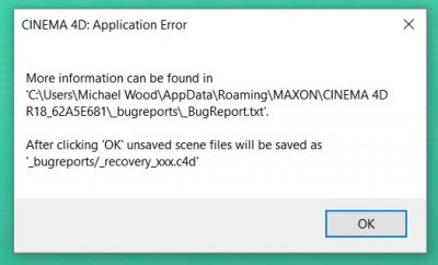

See scene crashing on picture viewer and bug reports below...Tried about 25 times to render this.
Crashing when render to picture viewer

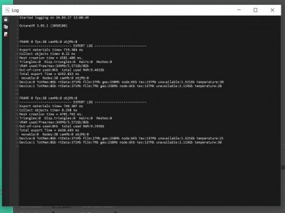

H. Render to picture viewer at 1080p gets to frame 2 then crashes with the 'Application error', its second frame everytime. Tried different drive to see if it was a write error or something, still same crash. I've also tried at 720p and still same crash. HOWEVER When I remove the hair it doesn't crash. Hair dynamics were cached also and still same crash.
I. How do I get log if application crash and Cinema closes? I opened window before rendering and it won't let me save before clicking 'OK' on application crash dialogue.

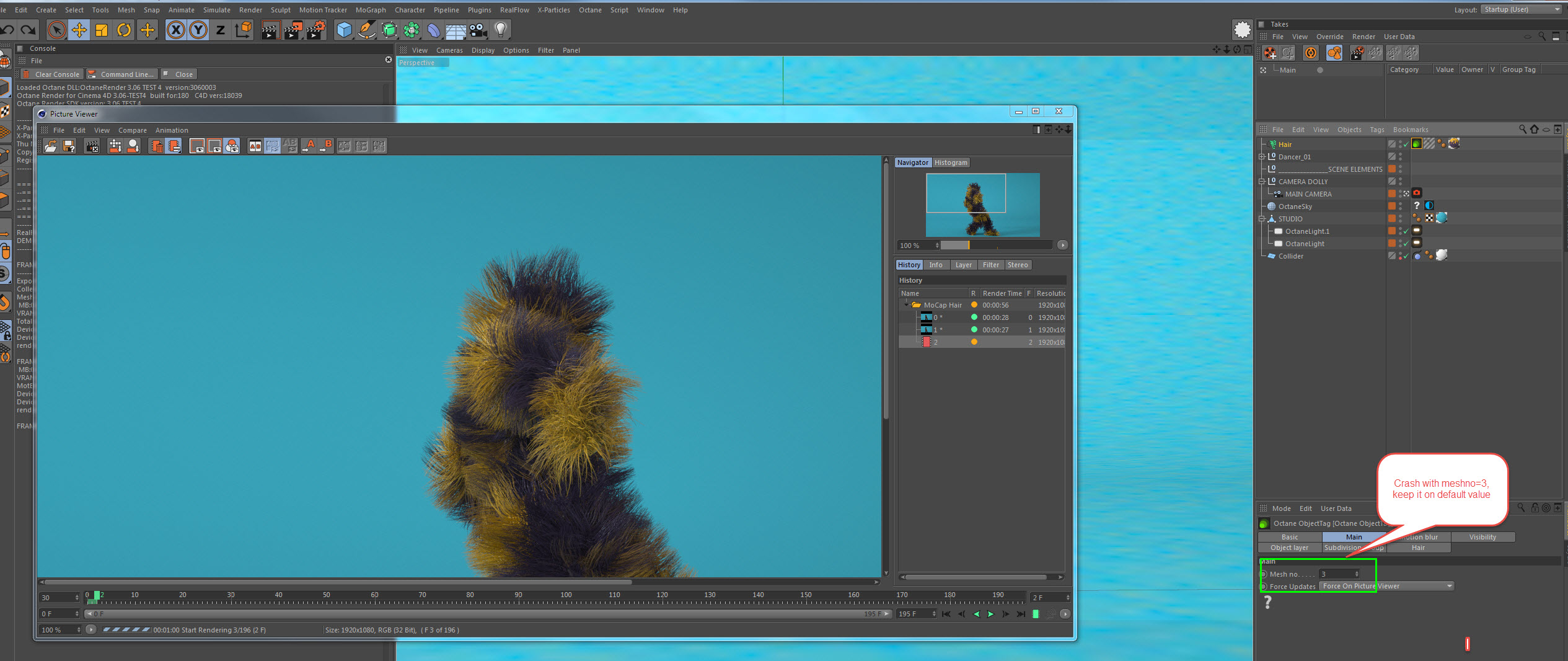

Thanks! It's crashing on me too. I'll investigate and let you know result.
Ok found the reason see picture. It's not fixable soon. Keep to use it as in notes. And you don't need to put object tag for hairs by default.aoktar wrote:Thanks! It's crashing on me too. I'll investigate and let you know result.

Just got home and tried it, works!aoktar wrote:Ok found the reason see picture. It's not fixable soon. Keep to use it as in notes. And you don't need to put object tag for hairs by default.aoktar wrote:Thanks! It's crashing on me too. I'll investigate and let you know result.
