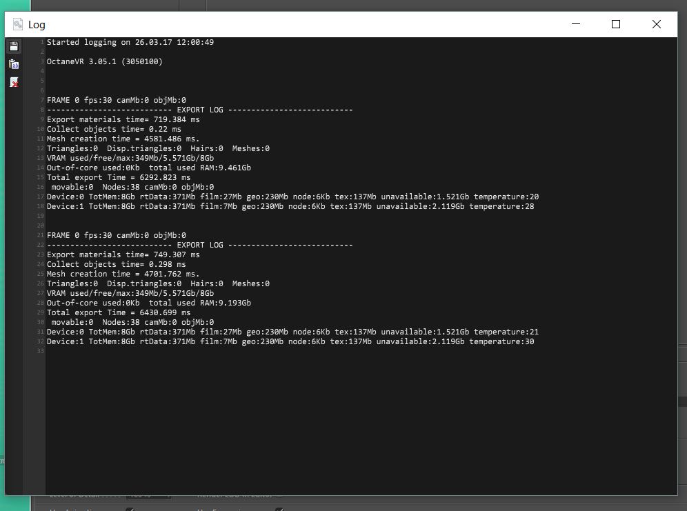

aoktar wrote:Thanks! It's crashing on me too. I'll investigate and let you know result.
Ok found the reason see picture. It's not fixable soon. Keep to use it as in notes. And you don't need to put object tag for hairs by default.
Just got home and tried it, works! :D
