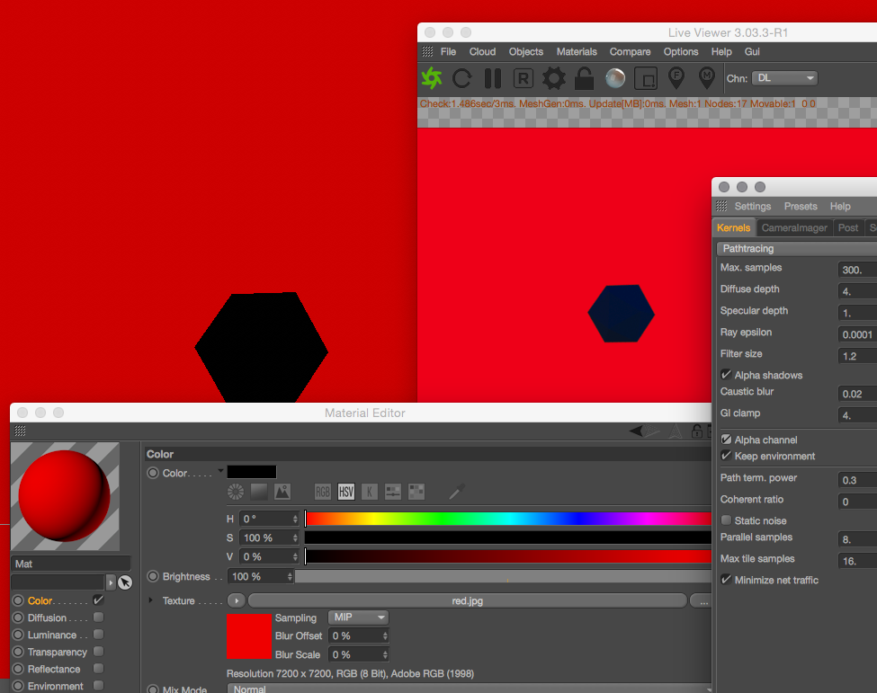

Not sure if this is the only solution, but it looks like it needs content and not just a color.
I tried loading a jpeg into your material and it loads show fine. If you want that color, maybe create a jpeg in photoshop with that red and load that into the color channel.

Ah ha! Originally I was using a video. I found out that wouldn't work after i started using the solid color as a test. Turns out that doesn't work either. I put in an image sequence and it works great.
So, good to know: background object must contain imagery.

Not just images. Also c4d shaders are possible but no video files.
