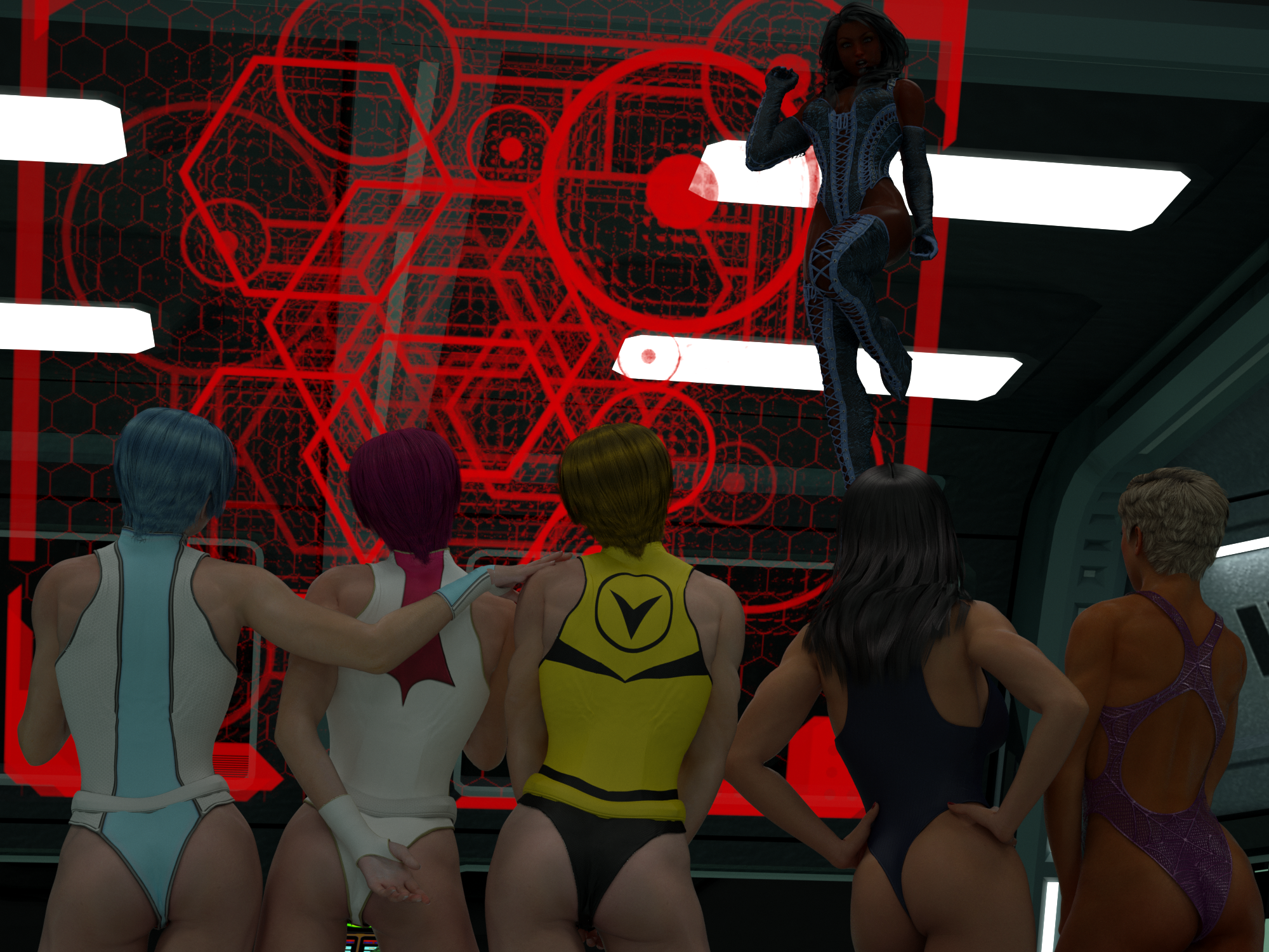

Show attached picture "Normal Rendering", it is my setting texture, it is same as Poser.

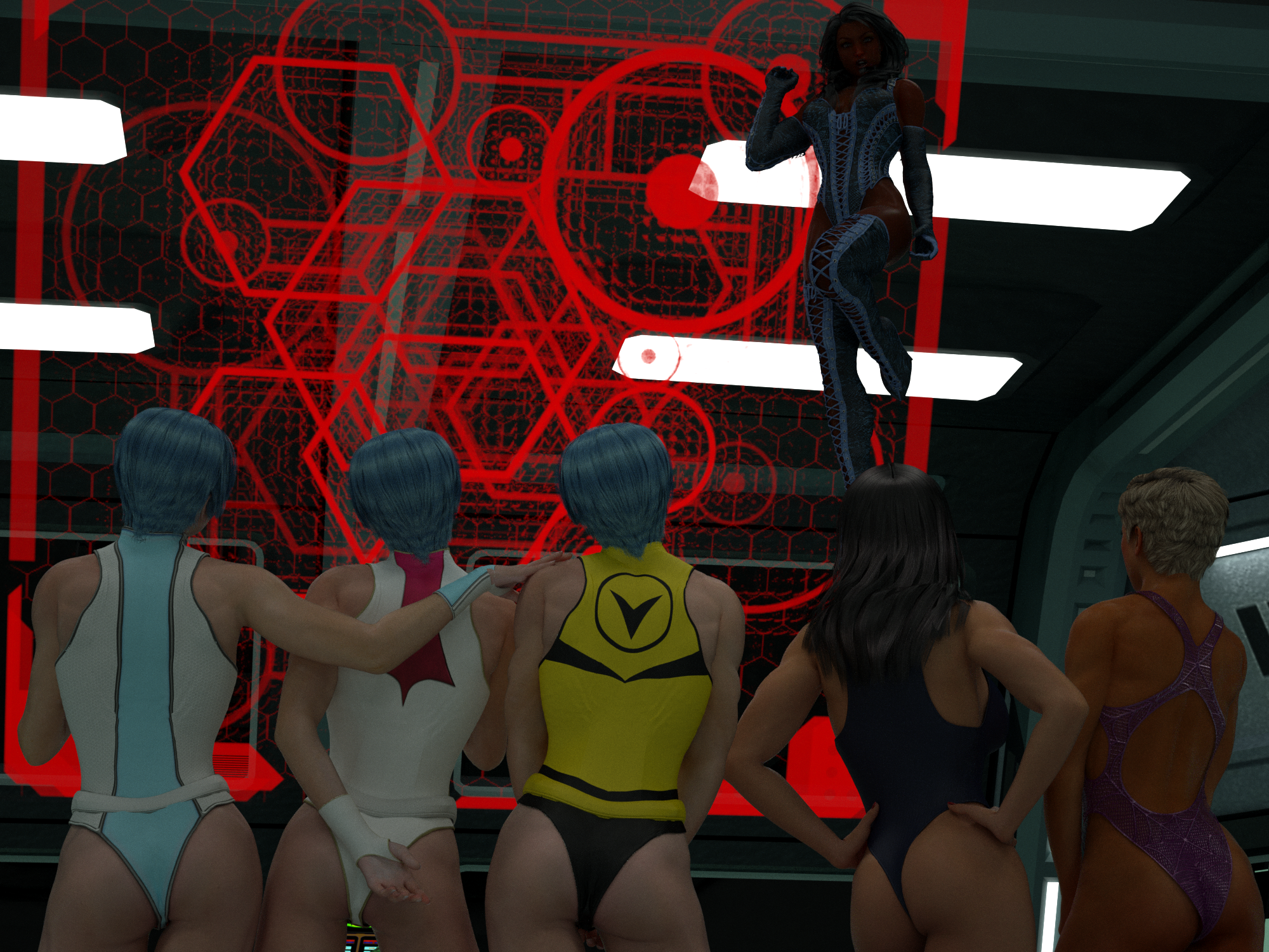

But after rendering of animation or after save data of this scene, this hair prop texture is wrong, show "Missing Texture on Hair Prop".
Those hair prop is same model with different texture.
Additionally, "Re Convert From Poser" dose not work correctly.
I set correct Texture setting by manually, but it is must lost by Octane, after animation rendering or scenes save.

As a quick fix, if you rename the BerlinHair prop from Victoria4 (and the other figures) to BerlinHair2, BerlinHair3, etc, then reconvert the hair materials for those props, it fixes the problem.

I'm unsure where this error is coming from. Can you post a screenshot of the error pls?show "Missing Texture on Hair Prop"
