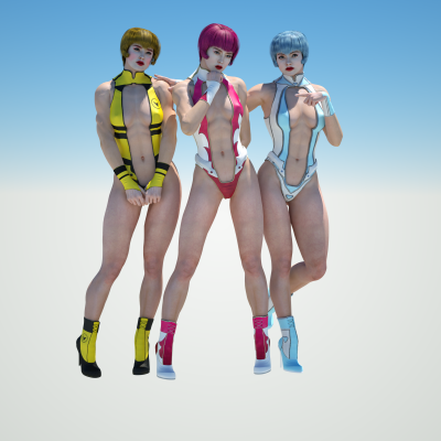

Show attached picture "Normal Rendering", it is my setting texture, it is same as Poser.

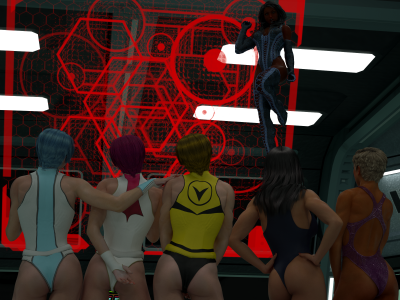

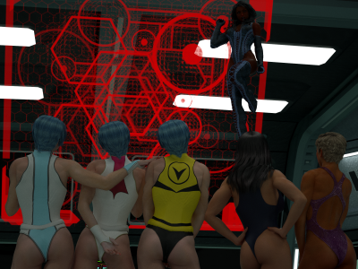

But after rendering of animation or after save data of this scene, this hair prop texture is wrong, show "Missing Texture on Hair Prop".
Those hair prop is same model with different texture.

Missing Texture on Hair Prop.
Normal Rendering
Normal Rendering

As a quick fix, if you rename the BerlinHair prop from Victoria4 (and the other figures) to BerlinHair2, BerlinHair3, etc, then reconvert the hair materials for those props, it fixes the problem.
