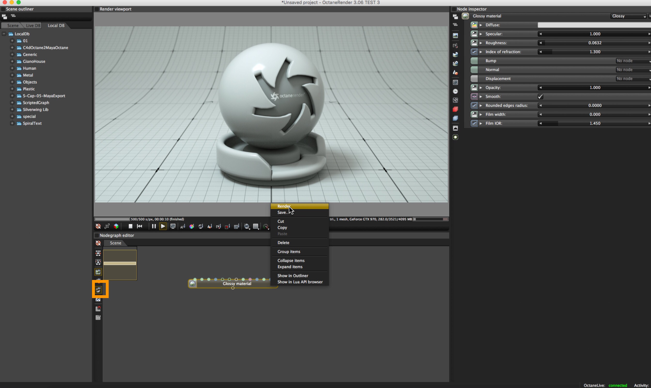

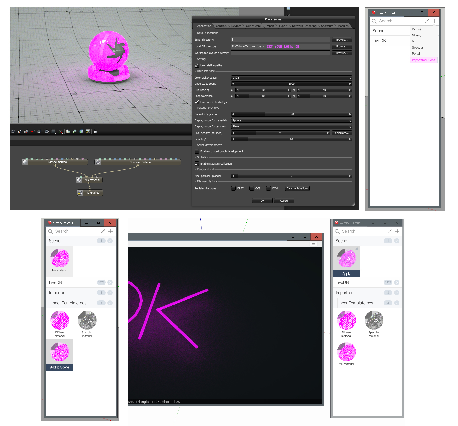

This is how to do it.
Works for more advanced materials that can cause troubles in the plugin.

Posts: 10536
Hi jorgensen,
you don't need geometry nodes for creating materials in Standalone. Right click anywhere in the node graph and create a material node. Right click on it and choose Render.
The material will be rendered in a preview scene called Material ball:
If you click the orange marked icon, the material ball will be instantly activated without right clicking on the node.
ciao beppe
