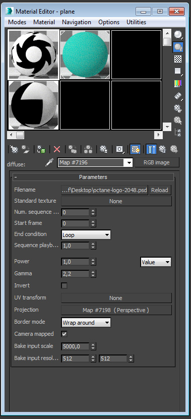

In diffuse texture slot, put your texture and set "perspective" and "camera mapped" (see project.jpg)

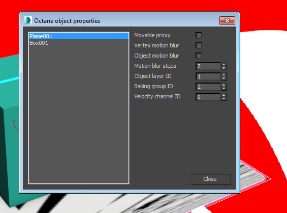

set a proper Id about object you want to bake (see id-obj.jpg)
create an octane baking camera and set same id

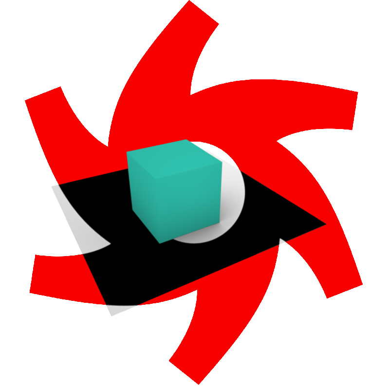

select camera baking and render
save the render and use it in diffuse texture slot for a new material.
apply new material to your object.
select octane standard camera and render.
