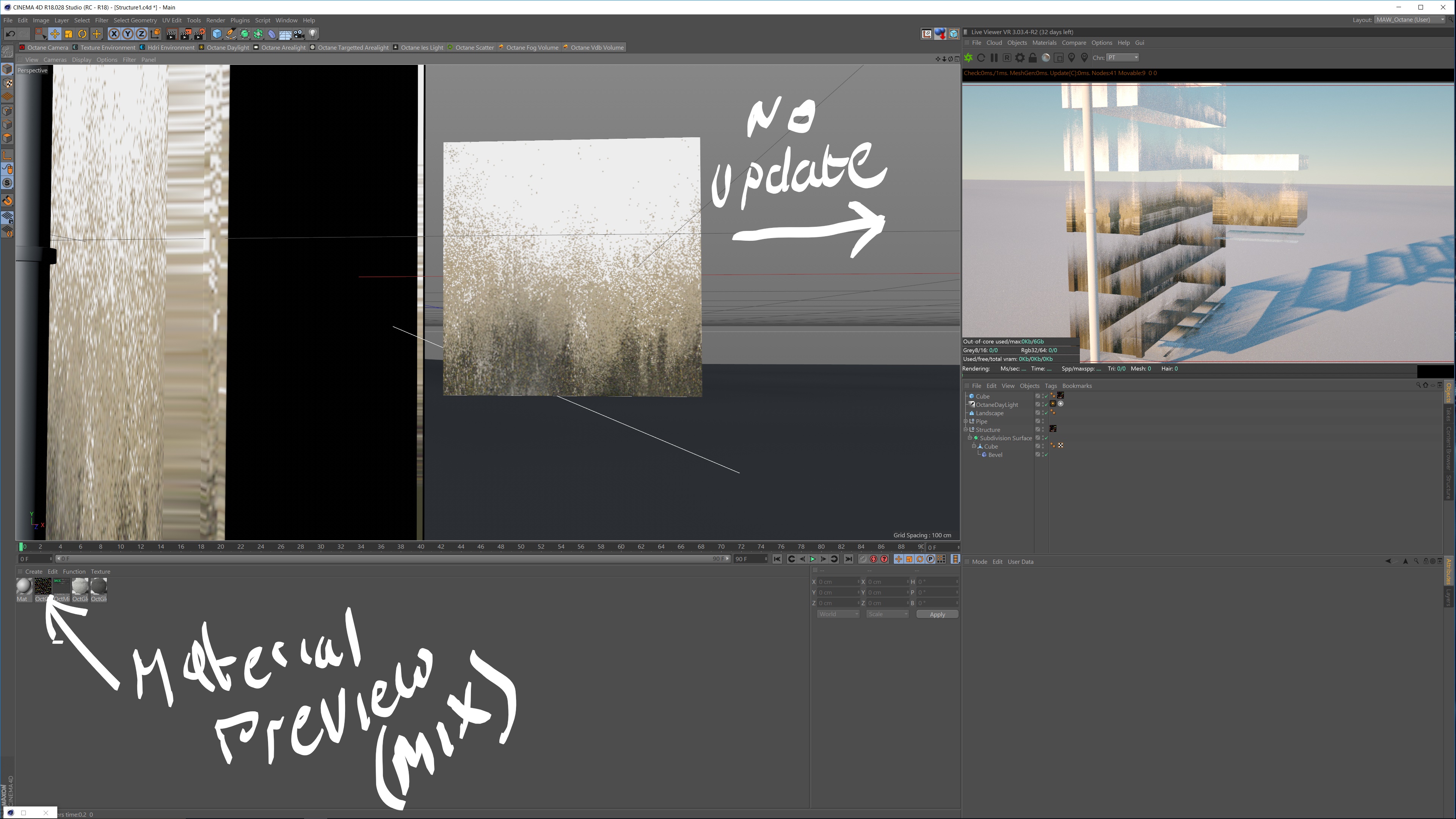

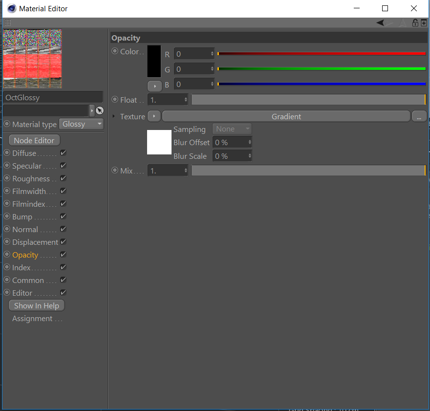

Being plagued by constant crashing so I've collated all the evidence to help you detect whats going on. I payed a lot of money for a duel 1080 rig just for Octane, coming from a Mac with an eGPU, thinking it would be like heaven compared to the issues I was having before..However, this is not the case as I'm having more issues to the point where I cant work anymore. First sign is when I'm working and material previews render distorted.
So first my materials go then my live viewer stops working. An actual render doesn't even start...The whole thing just stalls...Then after a few attempts at resending scene Cinema crashes, I either get a plugin error or it completely freezes up making me force quit Cinema via task manager.
Material preview

Yes rollback to different drivers. And you can find another builds under C4D/Releases section. For example: viewtopic.php?f=85&t=58047
Your errors(corrupt pixels) looks like something is wrong on hardware or related things on deep level. Not in plugin codes.

I've tried with benchmarks and everything works perfectly from the GPU side in that regard... I am going to roll back drivers now but I don't have much hope.
Could you give more information on what hardware issues it may be? I'm going back to the builders and I need as much info as I can give them.. Because for me Octane is the only thing giving me issues. Could it be pascal related?
I'm really stuck here.

Yes I removed all files then did a fresh install of both latest Standalone and C4D 3.05.1 plugin from link you provided. I started on a new scene and it worked for abit, but then got the same problem where the material screwed up and my live viewer crashed.aoktar wrote:have you tried 3.05.1 with correct installation?
