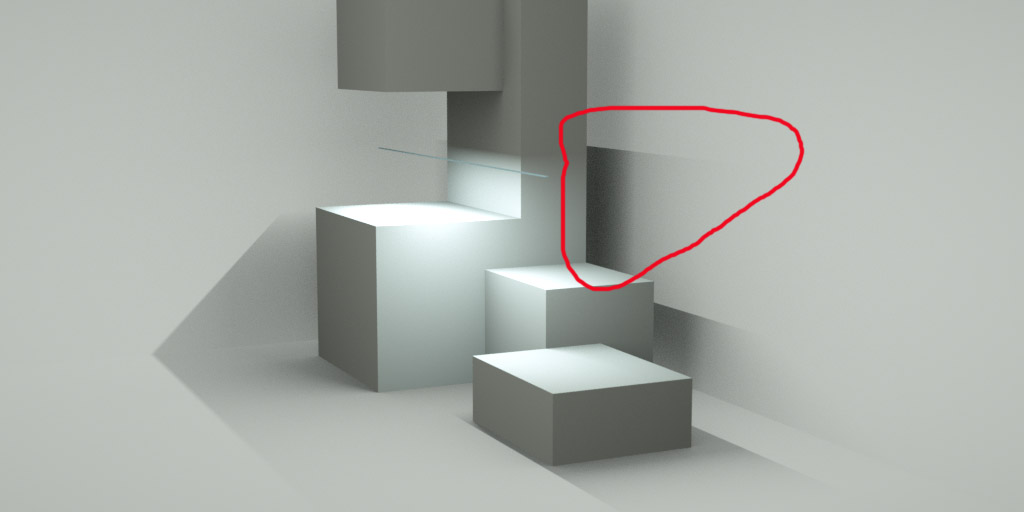

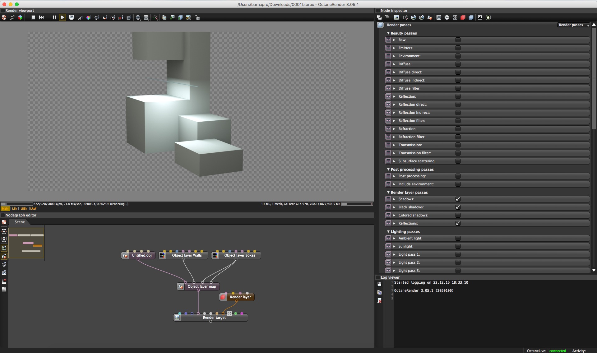

when the light on the shadow catcher appears this artifact
I want to use light and shadow catcher. But I can not do that.

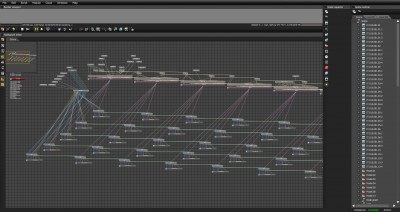

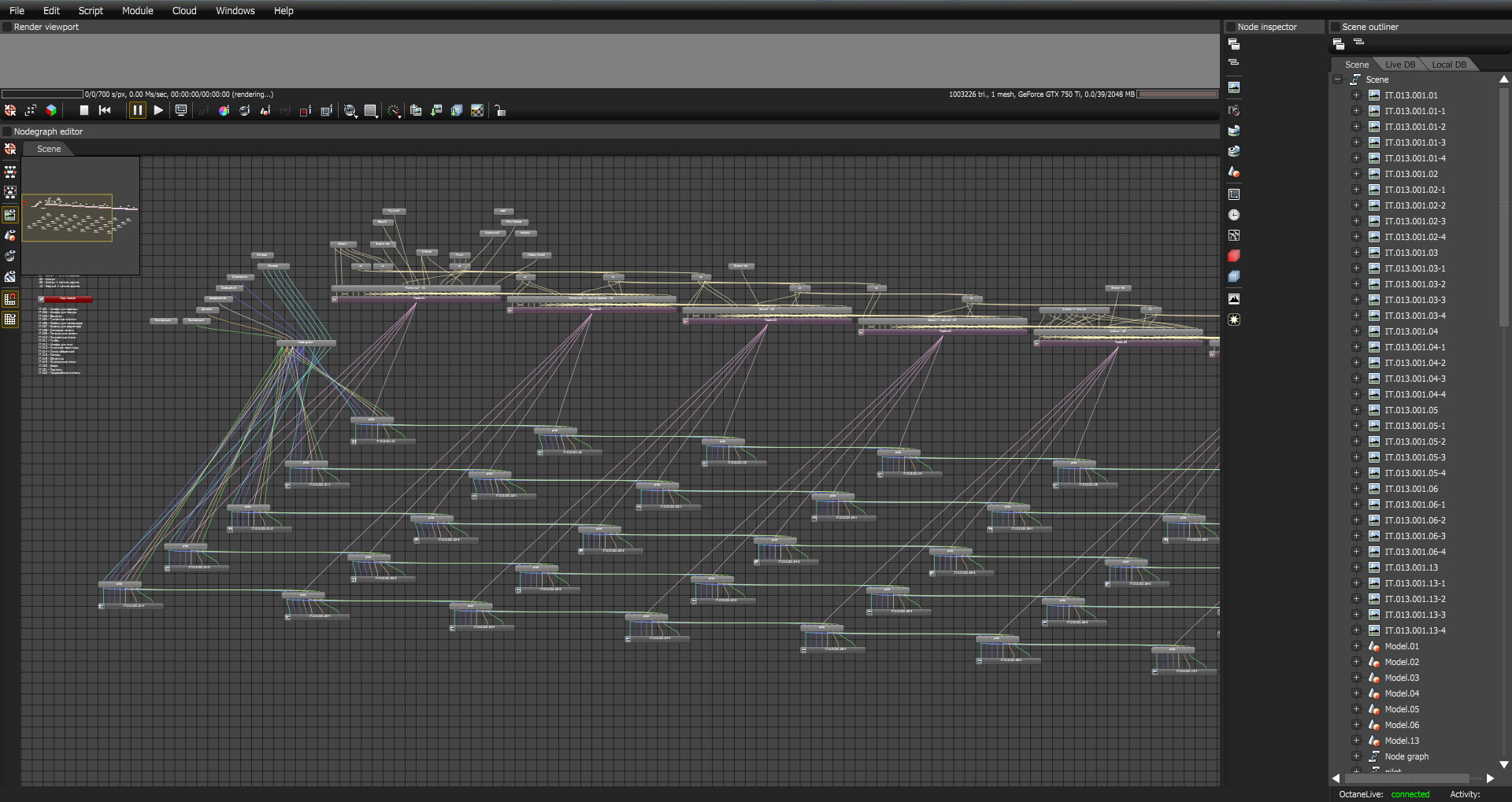

All this is great! But now my scene looks like.
5 cameras to 7 materials. 35 finished images to be obtained without post processing.
It is unfortunate that this bug will not be removed :(

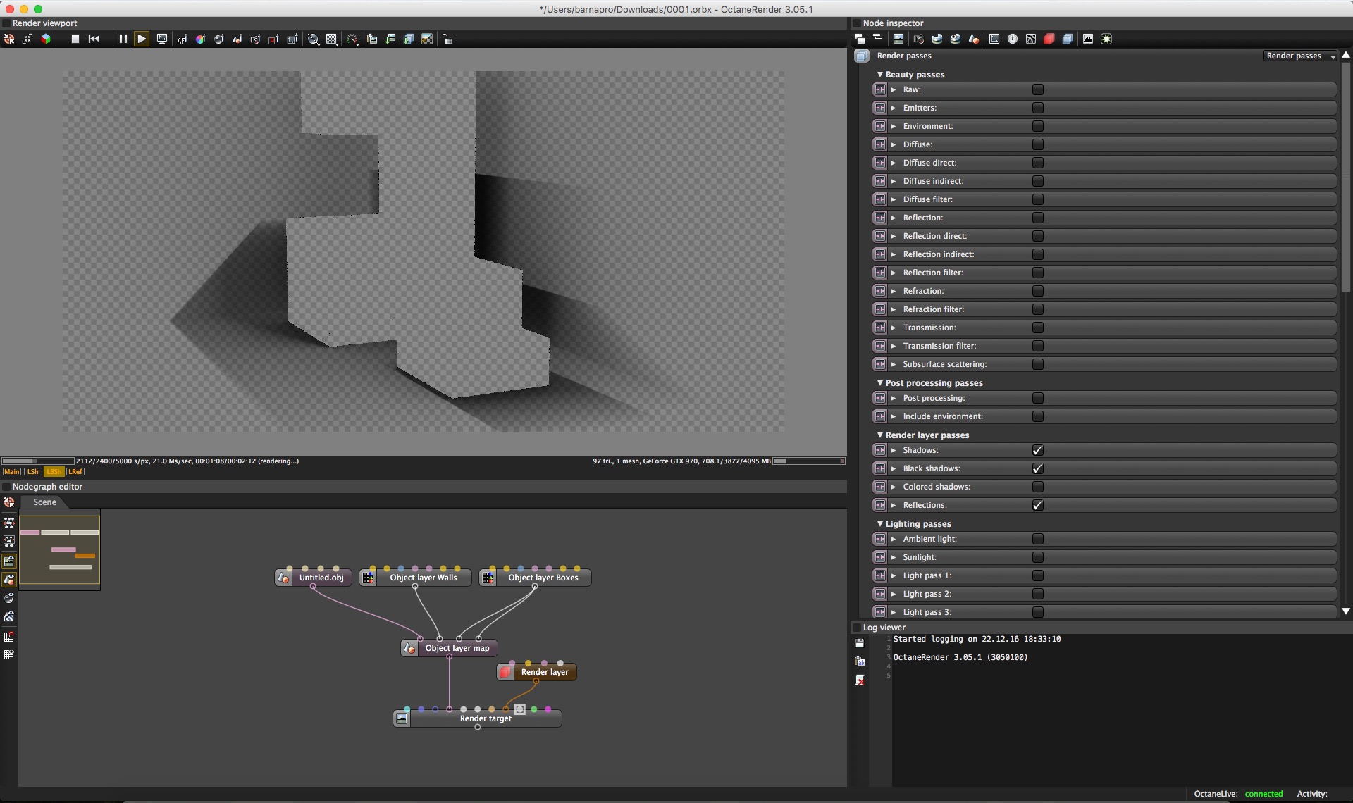

Posts: 10622
Hi ura,
sorry but from your screenshot, I'm not able to understand exactly your issue.
Could you explain it a bit more, maybe with a simple example scene?
ciao beppe

the problem has not disappeared

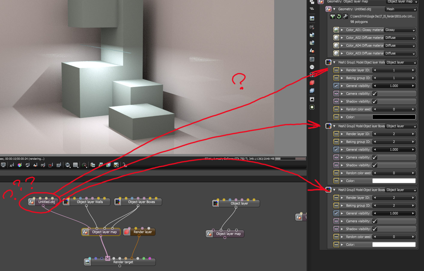

how is it to add layers to obj?

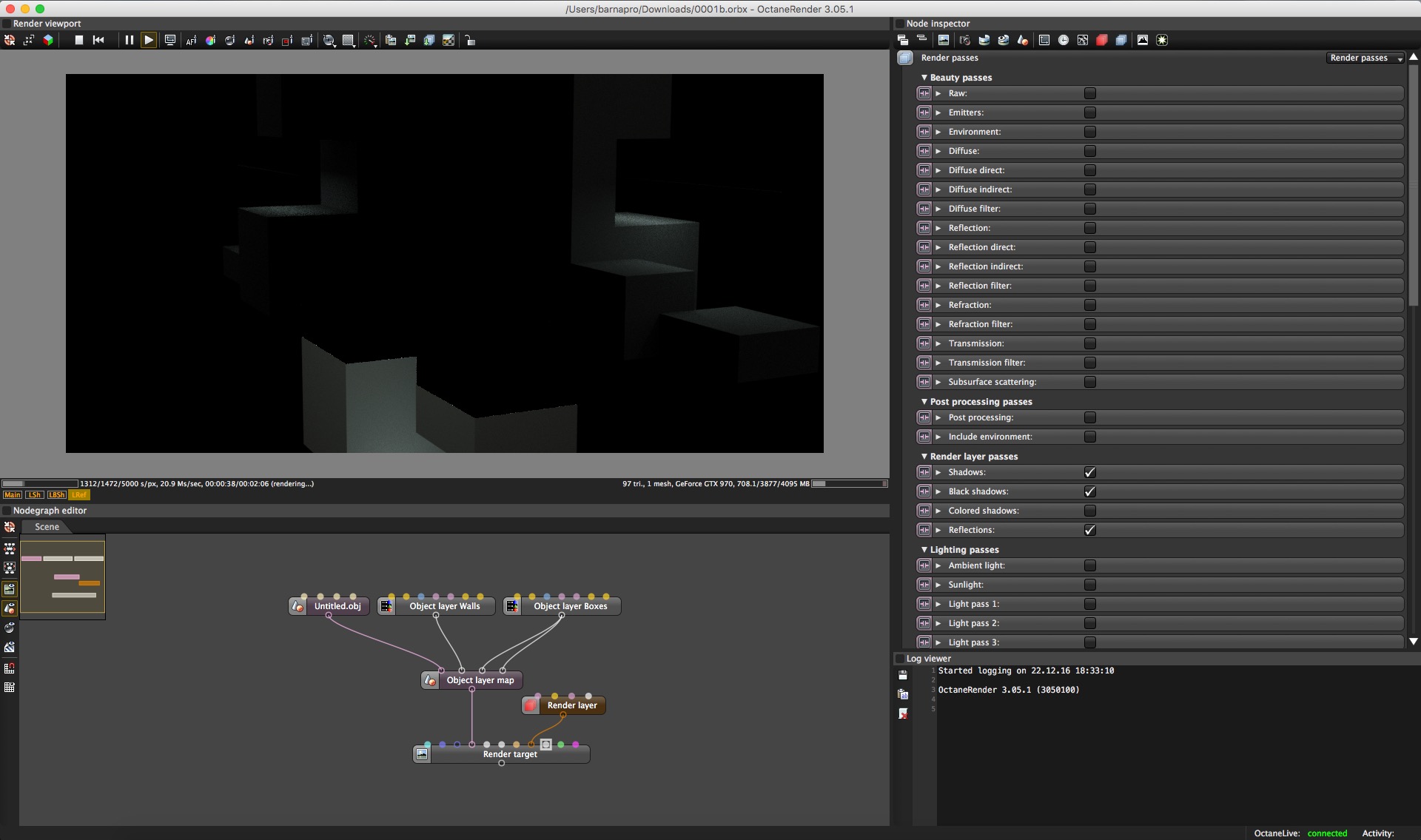

Posts: 10622
Hi ura,
the obj mesh is connected to an "Object layer map" node that exposes the object layer pins of the connected geometry.
ciao beppe
ura
Posts: 43
Joined: Tue Mar 22, 2011 4:54 am
Location: Russia
bepeg4d wrote:Hi ura,
ciao beppe
it is not clear how it works
