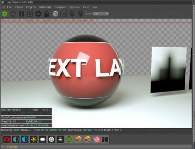

Pls check attached scene to see usage of a psd. But using seperated files are always better for plugin as Beppe said.
- Attachments
- psd.rar
- (197.08 KiB) Downloaded 183 times
