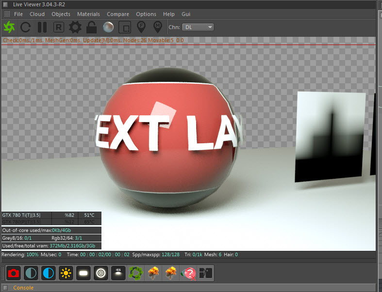

Posts: 16068
Location: Türkiye
Pls check attached scene to see usage of a psd. But using seperated files are always better for plugin as Beppe said.
psd.rar
