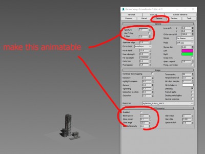

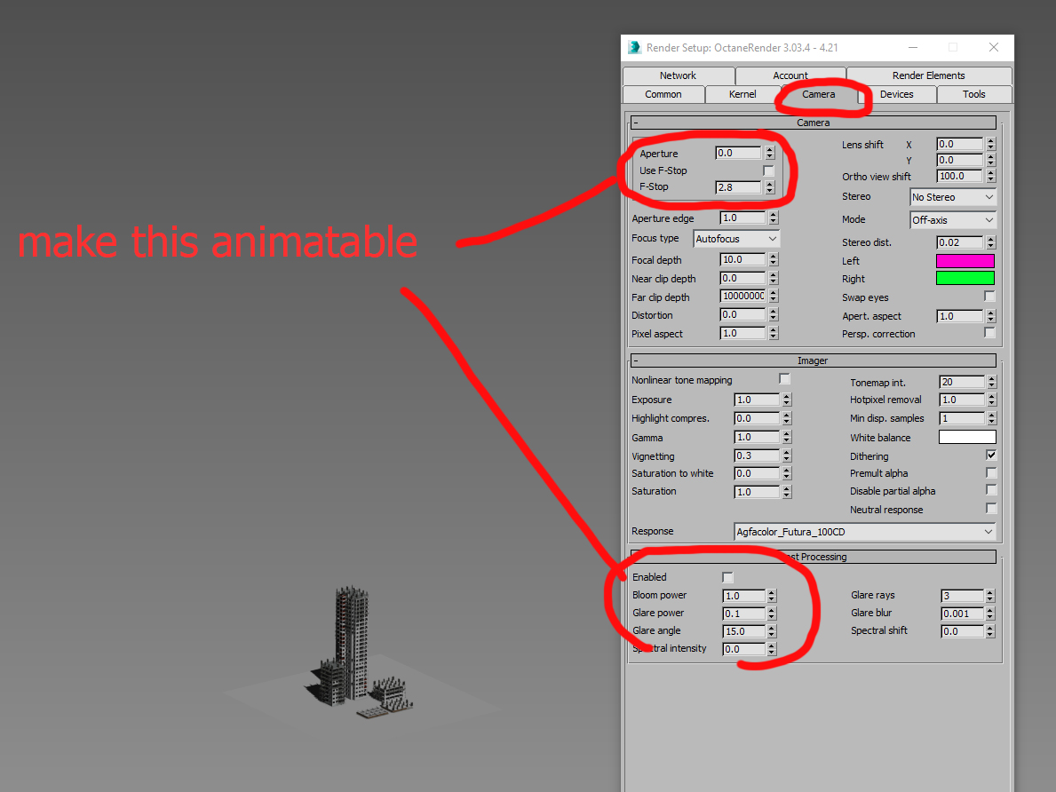

Animatable aperture in camera roll out
Please add animatable aperture and other options in octane camera roll out. We use regular camera because creating octane camera you have to redo all settings done in octane render camera roll out. Or at least a sync button that syncs all camera options with octane render cam roll out

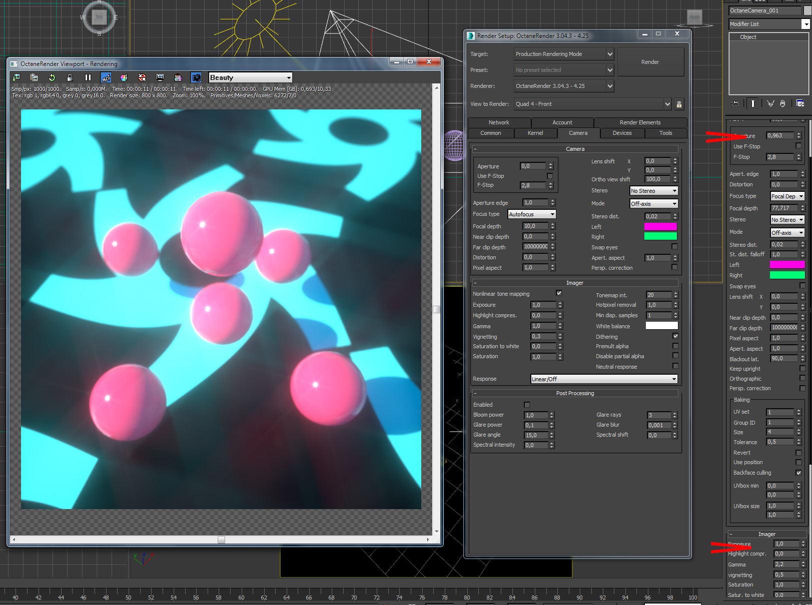

Hi guys,
they seem to work well with 3dsmax camera.
Why you do not use the camera Octane?
it also works well in animation, post processing, f-stop, etc you can animate them in 3dsMax timeline.
Screenshot attached scene
Regards
Paride
Regards
Paride

we do not use octane camera because every time we create octane camera all settings are defaulted and do not match octane render dialog settings Can we get at least sync octane camera settings to octane render camera settings
