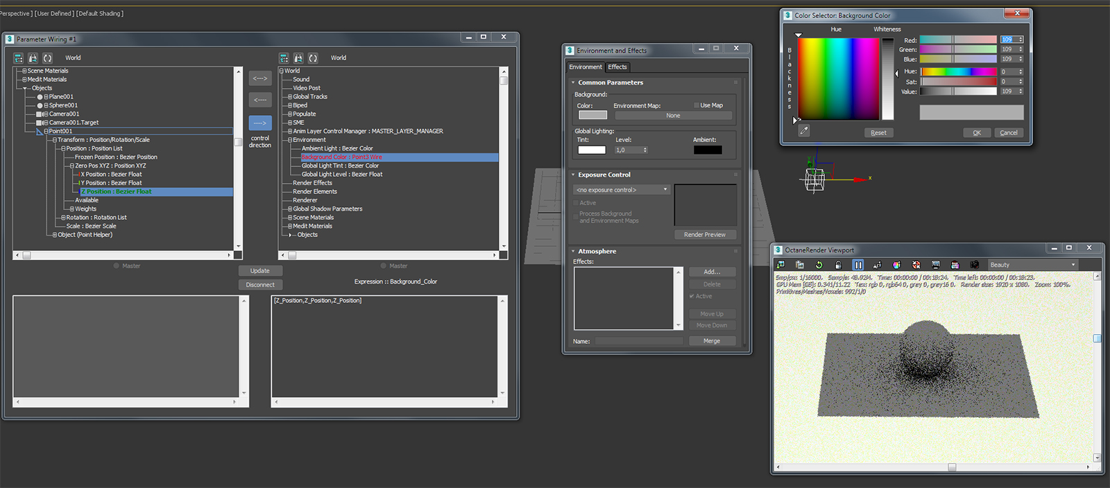

Here is a screenshot of how the pinthelper and the background color is wired
attached is a file with the issue.
Octane_viewportRender_refresh.rar
(26.65 KiB) Downloaded 231 times
its really basic.
a new scene with 2 objects in the scene, plane and sphere.
wired the pointhelper to the background color.
The file is setup so you can open it and hit the viewport render and it should give you the "bug"
best regards
-Mats

I asked advice to octane 3ds max plugin developers,
following their response regarding your issue.
Regards
Paride
"The Z value from the dummy is used my max to set the RGB value of the background color.
But the RGB value is clamped between [0.0 and 1.0] ..
So, when the Z value is outside this range (for example 17.493 cm, as in the sample scene), every frame, we detect that it's different from the color, and do a refresh..
Everything is ok when Z is set to 0.7 cm for example..
It's easy to set the Z value by right clicking on the 'Move" icon, that brings the X,Z,Y change dialog..
There might be some way to use a max script function in this Wire dialog, to clamp / adjust the Z value to make sure the RGB to set is in [0-1] .."
