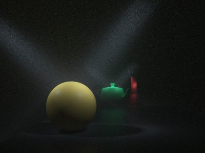

trying to replicate the look of the lighting juanjgon created for C4D & LW but just cant get anything close to it using 3dsMax
viewtopic.php?f=36&t=53505&p=269975&hil ... ax#p269975
anyone have any ideas ?

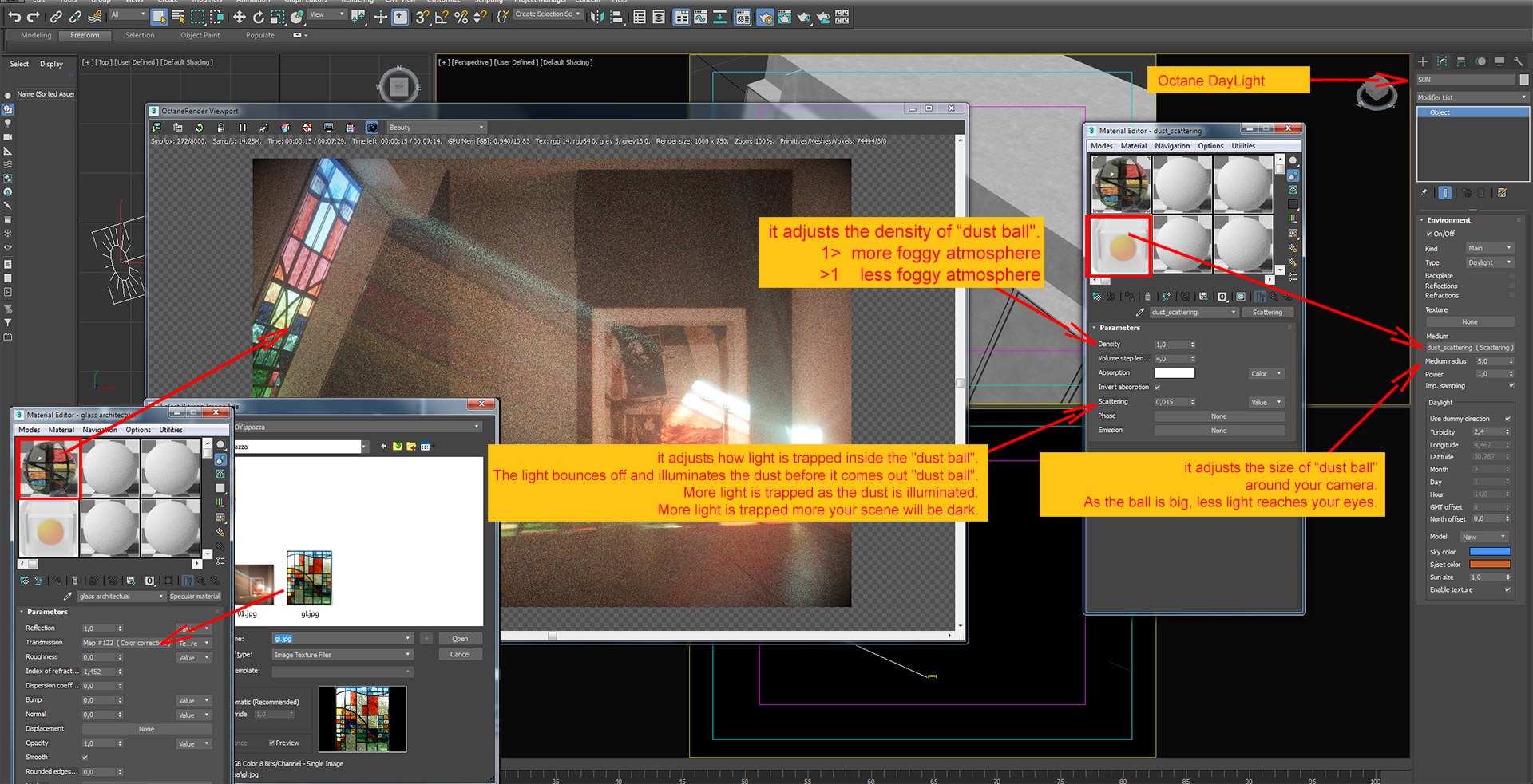

Hi tartanpimpernel,
This link might help you.
viewtopic.php?f=21&t=56599
Let me know your news.

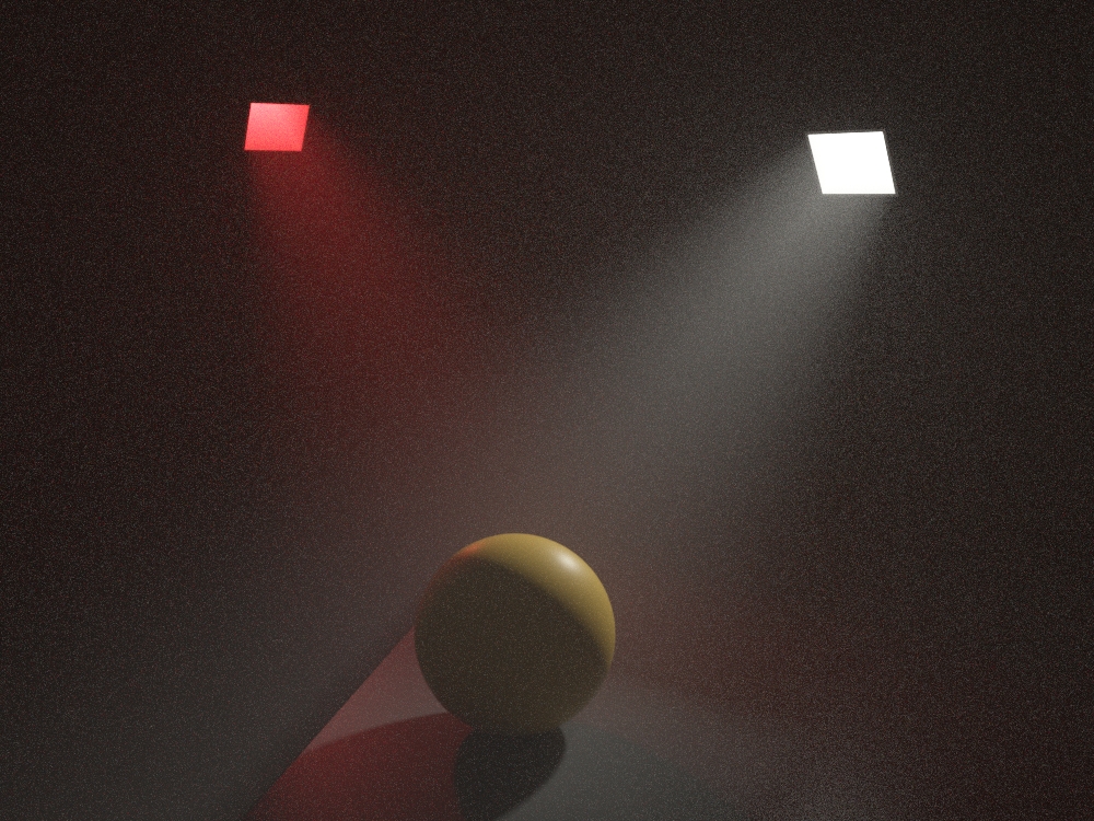

Hi tartanpimpernel,
just change the emitters, the rules are the same about it.
attached a file with the scene shown in screeshot.
Regards
Paride
Regards
Paride

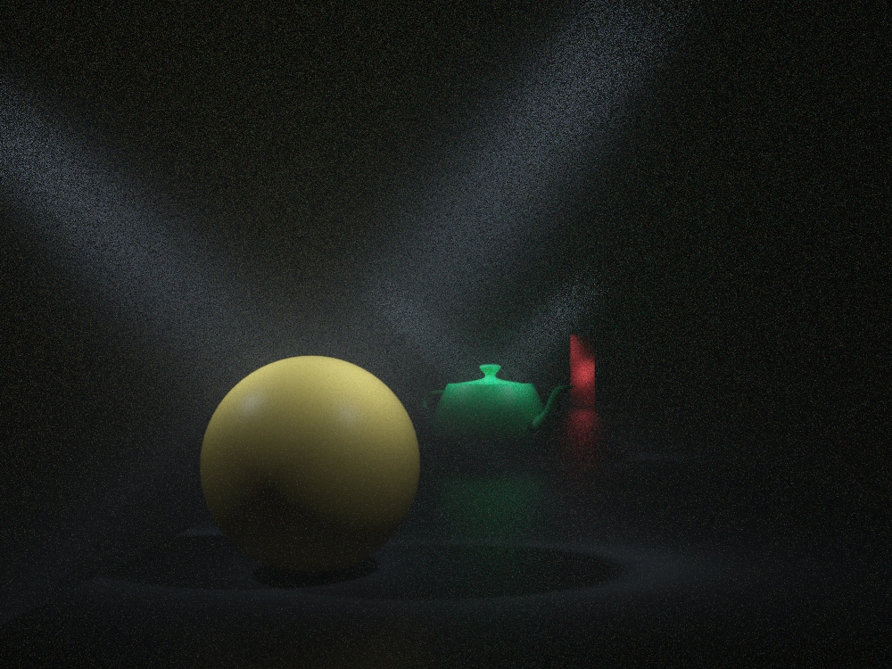

Thanks for the help paride4331, I had been using an ies opposed to a Sun and wasnt getting anywhere
just need to tighten up the contrast to the edge of the light volumes, drop some of the grain out and I'll be pretty much where I was hoping to be for my little project
has highlighted I really need to set some time aside and learn more about lighting
thanks again
thanks again
