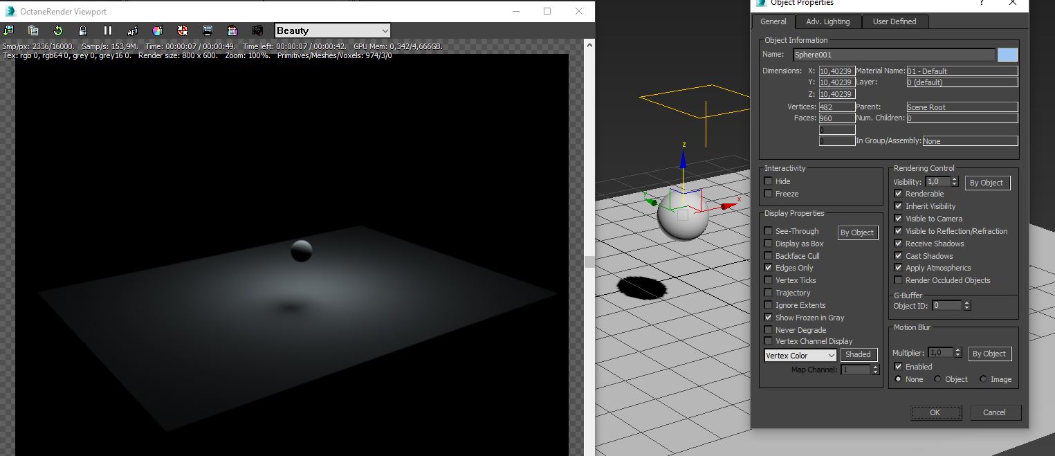

For Cast shadow. It just works in max....

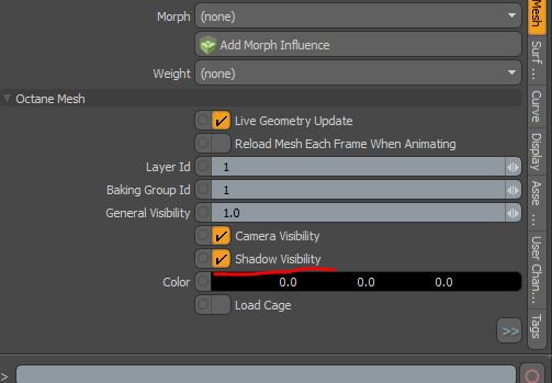

I just checked - and LFedit is right - unticking Shadow Visibility stops that mesh casting shadows.
