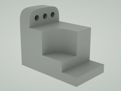

And here is the cycles render, which I would describe as my expected results:
adamnerva
Posts: 112
Joined: Mon Apr 27, 2015 9:01 pm

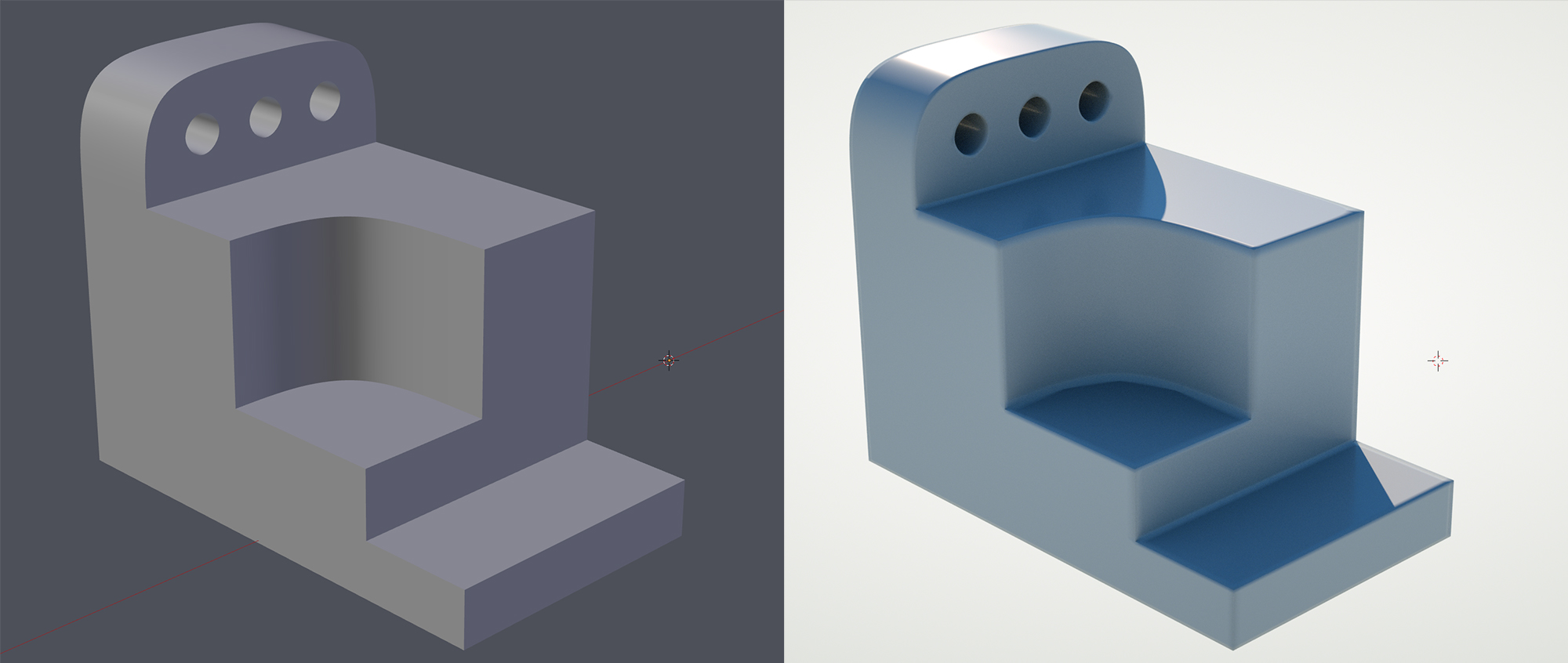

And here is the exact same mesh exported as OBJ and rendered in Octane Standalone. Expected results achieved. So the issue here appears to be that Octane for Blender does not read the mesh normals. Hopefully this is a trivial thing to correct.

Hi adamnerva,
Looks like you have rounded corners turned on in the Octane plugin render you posted.
Jason

grimm wrote:Hi adamnerva,
Jason
Actually, no I don't. And the blend file is included in the first post.

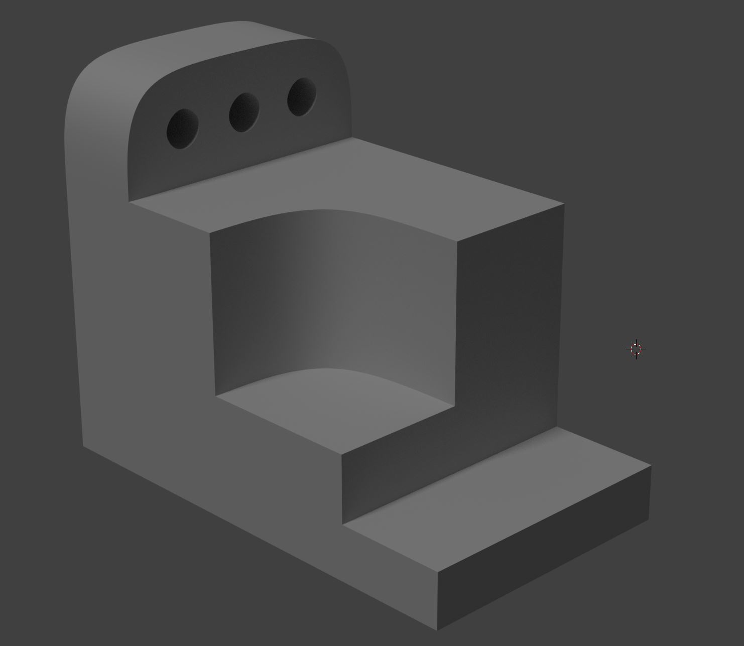

OK, the problem is definately that Octane for Blender cannot read vertex normals. New test file attached. This is a beveled cube with custom vertex normals.
https://dl.dropboxusercontent.com/u/276 ... Norm.blend
I consider this a pretty big bug that kills my workflow. I hope it can be addressed.

Issa wrote:Hello my friend,
it is good ?
No. That is not good. That actually completely disables the smooth shading, rendering every polygon as a facet. I need Octane to render meshes as Cycles does, and as standalone does: using the vertex normals.
