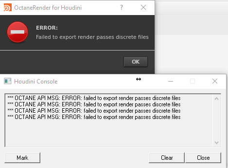

I've tried rendering half precision without multilayer EXR and I get an error "failed to export render passes discrete files".
Is this feature still not working?
Thank you!

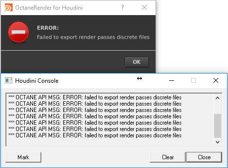

I'm still getting an error, this time whether half precision is selected or not, doesn't make a difference.
I don't see other people posting regarding this issue so it could be only on my end?
(on houdini 15.5.565)
can you recreate the error on your side?

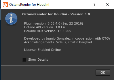

- octane version
- octane_version.PNG (17.46 KiB) Viewed 3903 times
Yes, sorry, I am aware about this problem, that as you say has not been fixed in the latest build.
It has been fixed now for the next build. Meanwhile you can use the multilayer EXR files, but if you need this feature now I can send to you a custom plugin build with this problem fixed.
Thanks,
-Juanjo
Thanks,
-Juanjo
This is a custom build with this problem fixed:
https://render.otoy.com/customerdownloa ... _Win64.zip
Thanks,
-Juanjo
Thanks,
-Juanjo
