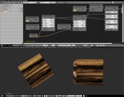

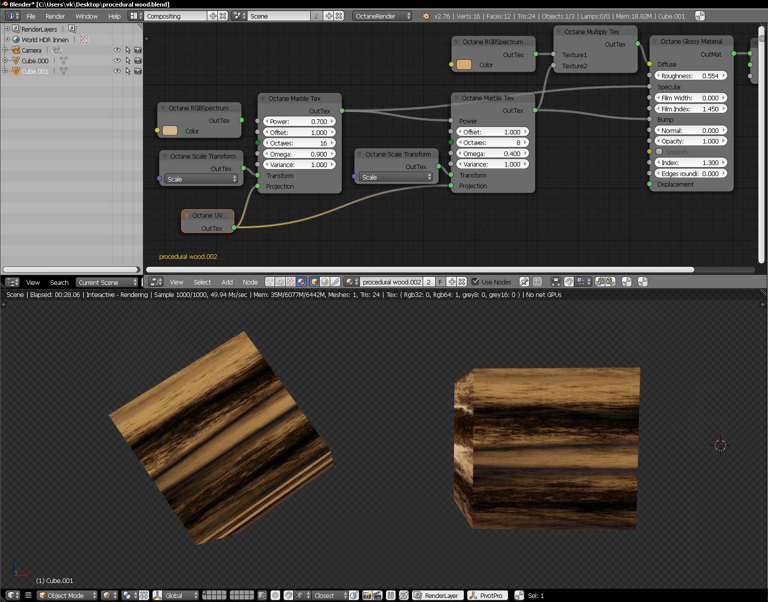

hi,
it works. You have to unwrap the object. Make sure you have the 'uvw projection node' plugged into the projection pin of the procedural texture.

Oddly I did UV Unwrap, but I forgot to save the map. That's why I was having so much trouble. Note to self: SAVE the map.
