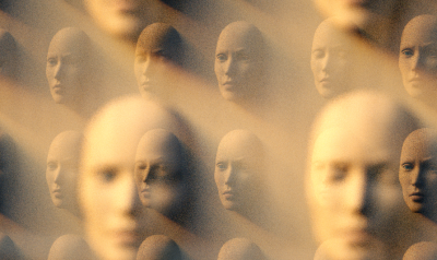

In my octane live viewer, I have exactly what I want :
the  octane Live viewer picture

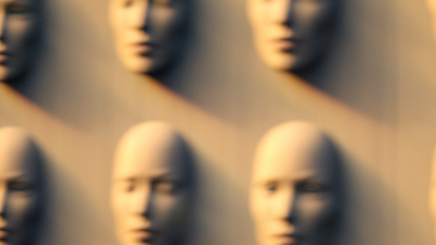

But when I try and render it, I have another result I don't like :
The C4D picture viewer render
I have the model, then a cube with 0.01 in Z and the "clear glass" material of the openlive DB, then the cam.
How can I render exactly what I have in the live viewer ???

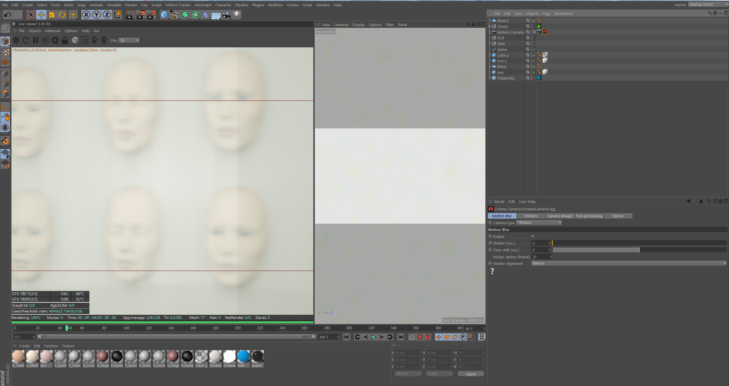

This what i get on LV with 2.25. How could you render out as like that? Also i see you have activated kernel overwrite in render settings.
