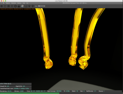

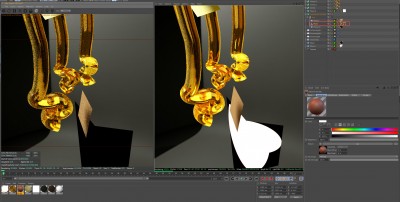

As you can see below the live view is different to the picture viewer. Scene is attached and also the render settings has the geo:resend only updated objects set.
You can see there seems to be issues with the very brightest highlights being in the picture viewer but not in the live viewer.

Sorry I was just messing around adding the tags to see if that was the cause, didn't mean to leave them on there when I was tearing the scene apart.
I thought C4D mats were converted, ah well lesson learnt, thank you so much for taking a look at this for me, its really appreciated.
Yes C4D mats are converted. But i think there needs a fix for this. After some versions emissions got a new parameters. It should be missed to be adopted for C4D->luminance channel on "Auto detect".bomperstudio wrote:Sorry I was just messing around adding the tags to see if that was the cause, didn't mean to leave them on there when I was tearing the scene apart.
Nice. Btw don't use object tags on every objects. It causes performance loss on viewport for complex scenes. Just use when you really need.
