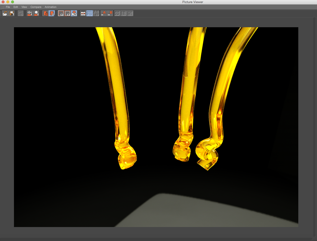

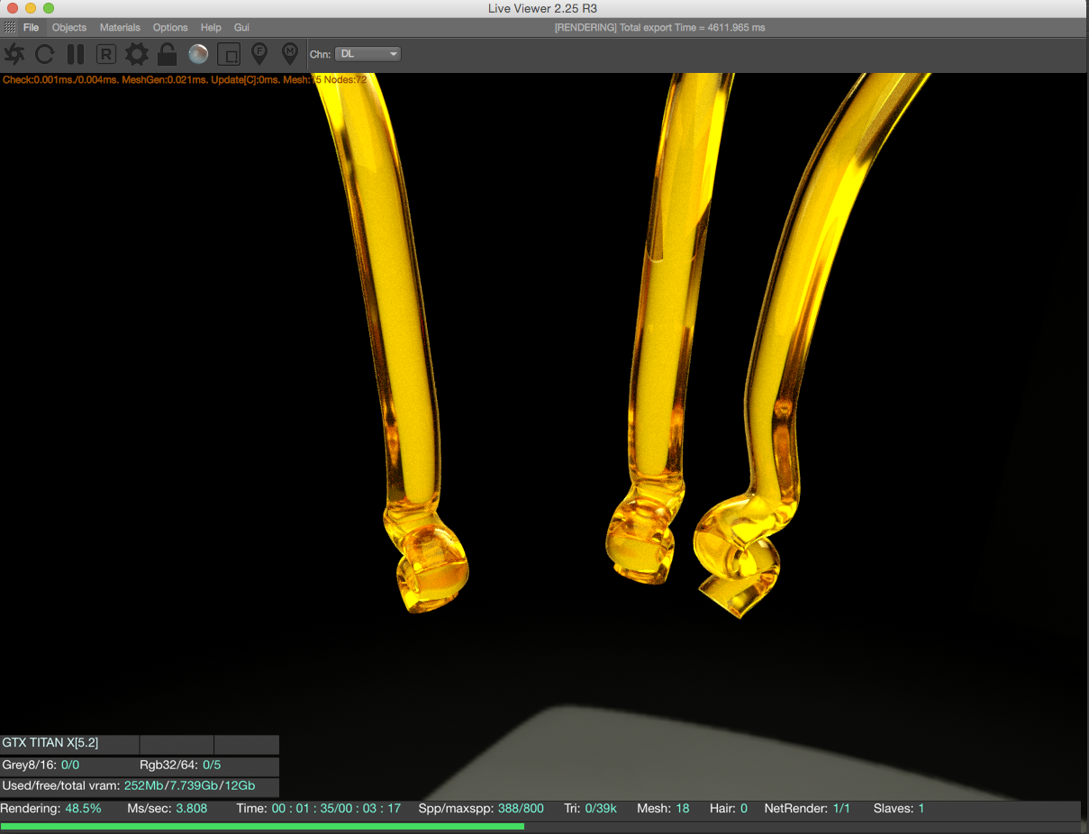

As you can see below the live view is different to the picture viewer. Scene is attached and also the render settings has the geo:resend only updated objects set.
You can see there seems to be issues with the very brightest highlights being in the picture viewer but not in the live viewer.

I'm checking. Btw here why do you use Object tag on every objects?
This is the reason of difference. Use octane material with texture emission to fix it.

Yes C4D mats are converted. But i think there needs a fix for this. After some versions emissions got a new parameters. It should be missed to be adopted for C4D->luminance channel on "Auto detect".
Nice. Btw don't use object tags on every objects. It causes performance loss on viewport for complex scenes. Just use when you really need.
