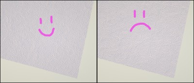

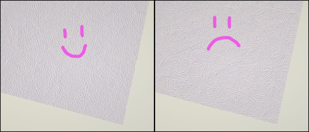

Hi
I always have a problem .
if i render just use bump map. Its OK , Just use displace maps ,its be right.
But Bump + Displacement map .Its always render some issue. You will see model's wireframe. Its not smooth shading.
Image Only Bump
Image Only Displacement
Image Both
Displace+Bump_demo.zip
(180.82 KiB) Downloaded 223 times

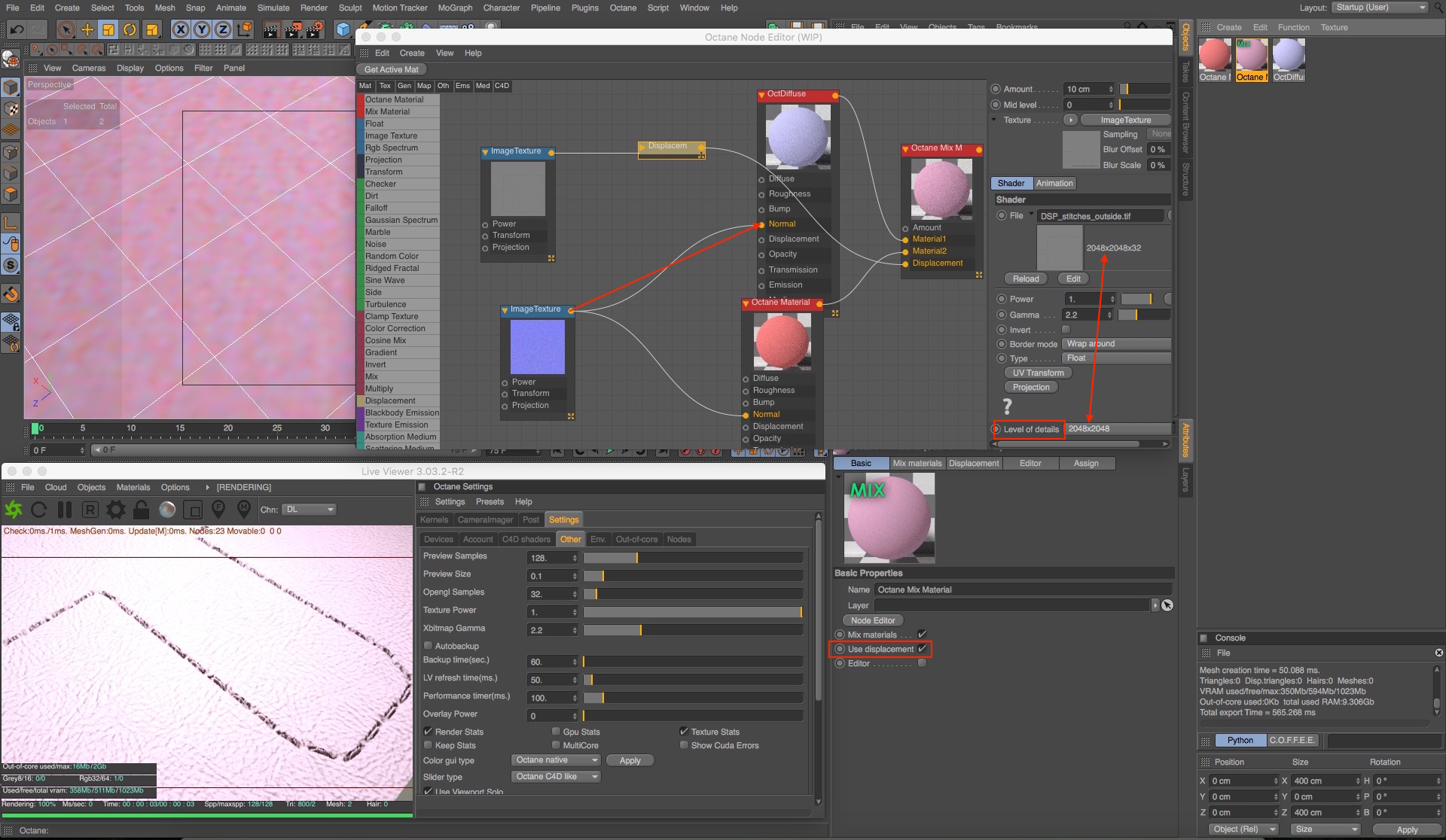

Posts: 10598
Hi red-juice,
sorry for the late answer, I have missed your post with the scene :roll:
Octane Displacement is different but it works, here is your scene revisited:
Untitled_b.c4d.zip
(114.92 KiB) Downloaded 213 times
You have to enable Use displacement in the mix material and connect the normal map to the proper pin in both materials. Then set the Level of details at 2048, like the resolution of the disp texture, for better results.
If you use 32 bit displacement texture, you can have even better results ;)
ciao beppe
edit: it is very important to have correct uv unwrapped without overlapping with geometry more complex than a single plane.
