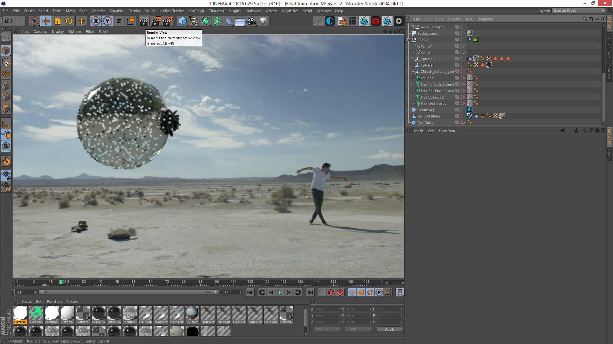

I am having some issues with x-particles and octane render. For some reason when I render particles in octane they are subtracting from my object in the scene revealing the background and not being rendered on their own. The only way you can see them is when they are in front of the object. I am just using a standard emitter that I want to emit from the object. The particles render fine in the physical render and the standard but when I go to octane it gives me the results in the picture. I have attached an image with this post. Any help would be much appreciated.

So this has something to do with the version I am using?
Posts: 16068
Location: Türkiye
Yes, there was an experimental option in LV as "particle engine". Now it's on Octane Object tag.
