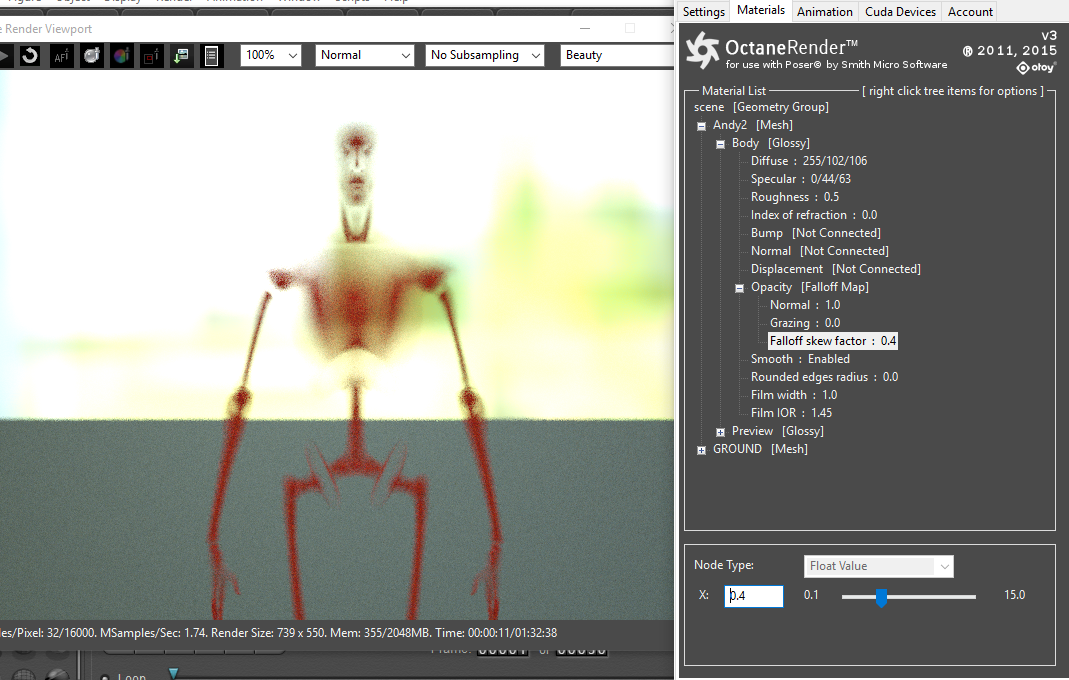

Set the Opacity node type to Invert, and set the Invert Texture pin to a Falloff Map. Try Normal = 1, Grazing = 0 for the Falloff Map.

its the same don't change :-(

It works fine for me. What render effect are you trying to achieve?

I managed to do that effect putting on normal 0.5
and using a ball ... but I can not with this prop to have the same effect :-(

You need to use the opposite\Grazing and Normal values to what you are using to get that effect.
