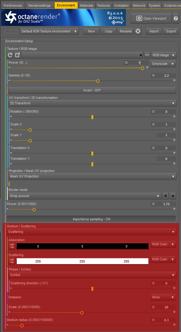

It all really depends on the lighting in your scene.
Try to have one direct light source, either in your HDRi map, or use the Daylight environment (it's easier to get great results with this).
I attached a screenshot, showing you some starting point settings. If your scene is not visible after applying these, try playing with the medium scale and medium density nodes.

Thanks man! I'll dive into this as soon as possible.
