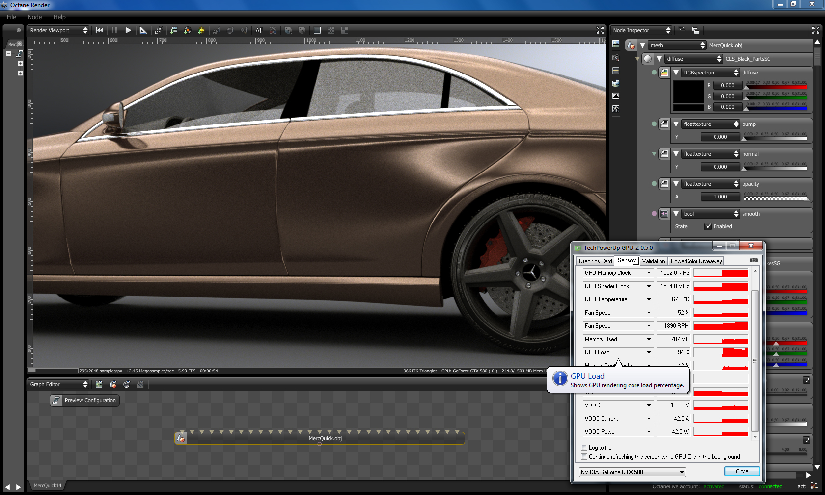

You have the tool that's shipped with Cuda toolkit and it's called "Visual Profiler".... Or the simplest way to monitor GPU cores usage is GPU-Z ver 0.5, hope this helps.
If you check the graph in GPU Z you'll see that with Cuda 3.2 (Octane 2.4 ver) cores are constantly on 95%, wheres on 2.3v5 there's oscillation in the cores usage. This is (i believe:) where the difference in speed is coming from. Sorry for my English.

Unfortunately, there is more to speed than only the number of cores. All these additional cores are only of any help, if you can utilitze them, i.e. the code runs fully parallel. How parallel things can be executed, depends on the geometry, materials and kernel settings and other stuff. -> An increase of 50% render speed is not possible and won't happen.
Also make sure that you disable alpha shadows if you want to compare render speed.
