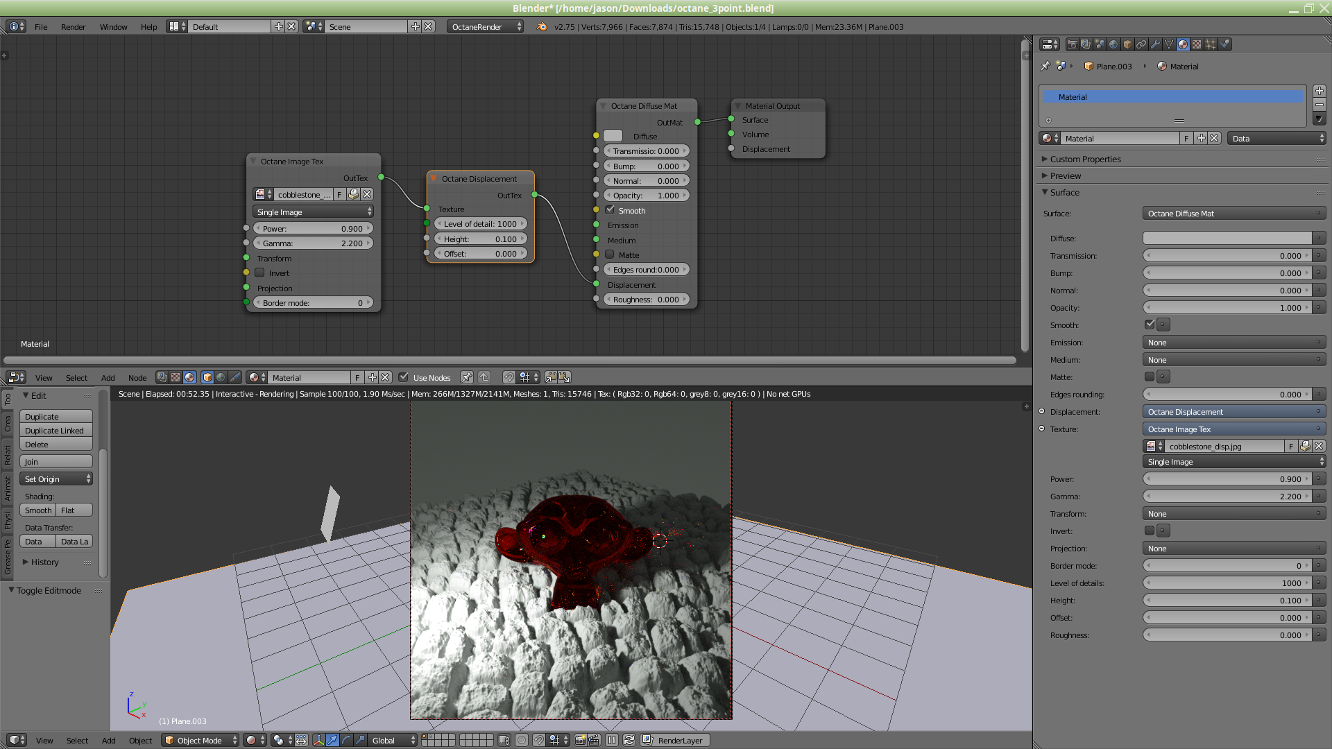

EDIT: Cant upload files!
For grimm: http://www.pasteall.org/blend/37366
For Jim: http://www.pasteall.org/blend/37367

grimm
Posts: 1332
Joined: Wed Jan 27, 2010 8:11 pm
Location: Spokane, Washington, USA
Thanks Mib your blend file helped, but I still don't remember having to setup a texture node to get it to work. It's ironic that I don't have any problems with displacement, I can add a blend for you if that would help?
Linux Mint 21.3 x64 | Nvidia GTX 980 4GB (displays) RTX 2070 8GB| Intel I7 5820K 3.8 Ghz | 32Gb Memory | Nvidia Driver 535.171
mib2berlin
Posts: 1194
Joined: Wed Jan 27, 2010 7:18 pm
Location: Germany
Thanks, may you can check the second .blend.
Sometimes I get it to work but not every time with exact same settings, no idea why.
Cheers, mib
Opensuse Leap 42.3/64 i5-3570K 16 GB
GTX 760 4 GB Driver: 430.31
Octane 3.08 Blender Octane
grimm
Posts: 1332
Hey Mib,
You needed to unwrap your ground plain before you can use an image to displace it. :)
mib2berlin
Posts: 1194
Location: Germany
Argh, every time these simple solutions, tsk tsk.
Many thanks. :)
