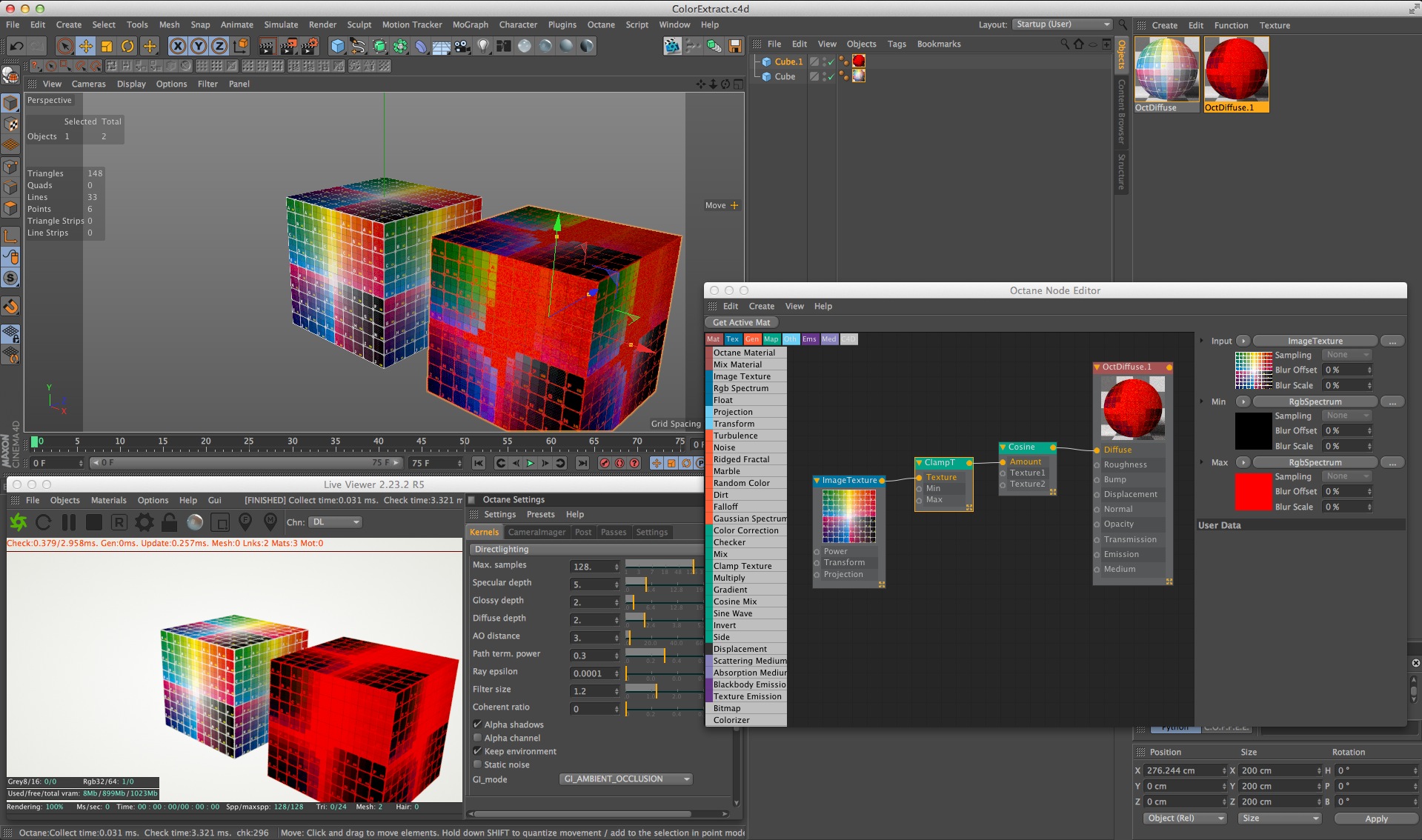

Hi. Need a help. I have simple material with image texture in diffuse channel, but I need to extract Green Color channel from this texture for use as a mask in a Normal channel. Thanks!

I think that the faster way is to get the green channel in PS or GIMP and use it in the amount channel of a mix texture node :roll:

Yes, but I need extract different channels from one texture for economy VRam memory, because I have big 8K textures. And adding each additional image to project will "eats" 256 mb of VRam.

Ok, now is more clear why you need this, here is a possible solution, I have not played a lot but i think you can get what you want in this or similar way ;)
ColorExtract.zip
(535.29 KiB) Downloaded 203 times

bepeg4d wrote:Ok, now is more clear why you need this, here is a possible solution, I have not played a lot but i think you can get what you want in this or similar way ;)
ColorExtract.zip
ciao beppe
Thanks a lot . I will test this method.
P.S. I find another method,but it has a big disadvantage. It uses C4D shader "Filter".
