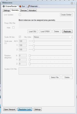

Hi Philipp
You need to click the Live Geometry checkbox in the Geometry tab for each item in the scene, OR Settings->OctaneRender->Live Updating=All Meshes Live. Then each mesh will be a separate Mesh object in Octane and you can enable the Object Id pass and then select it from the Viewport render pass combo box.

Hi Paul,
sorry for the late reply. My second reply and your reply were nearly on the same time, so I only got one Email.
Ok, I tried both methods, tried it in several scenes, with blocks and normal objects, exported it to Octane standalone, but no, all objects have one id and are displayed in a dark red in Rhino and Octane sa. All the other passes work. Only the object id doesn't.

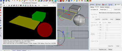

What is you Settings->OctaneRender->Live Updating set to? Try it on All Meshes Live - that should work.
Paul
Paul
Attached is a screenshot showing it works - and the rhino scene from the screenshot. Perhaps that helps you?
Paul
Paul
