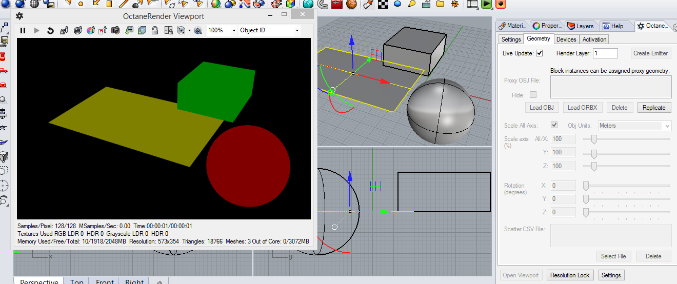

Attached is a screenshot showing it works - and the rhino scene from the screenshot. Perhaps that helps you?
Paul
Object Id.zip
(228.53 KiB) Downloaded 374 times

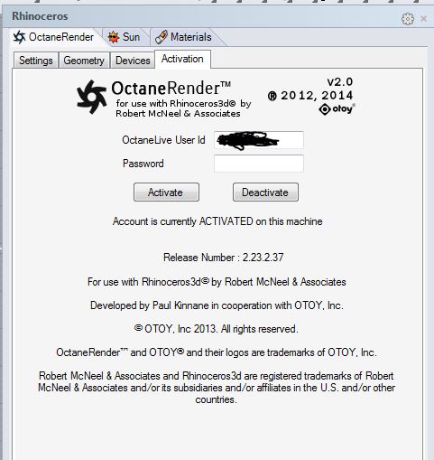

Ok, that is totally different from what I have. It seems you have a newer version.
Edit: I have Rhino 5 x64 SR11
MySettings
MySettings
MyVersion
MyVersion
