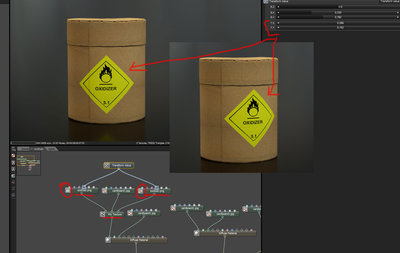

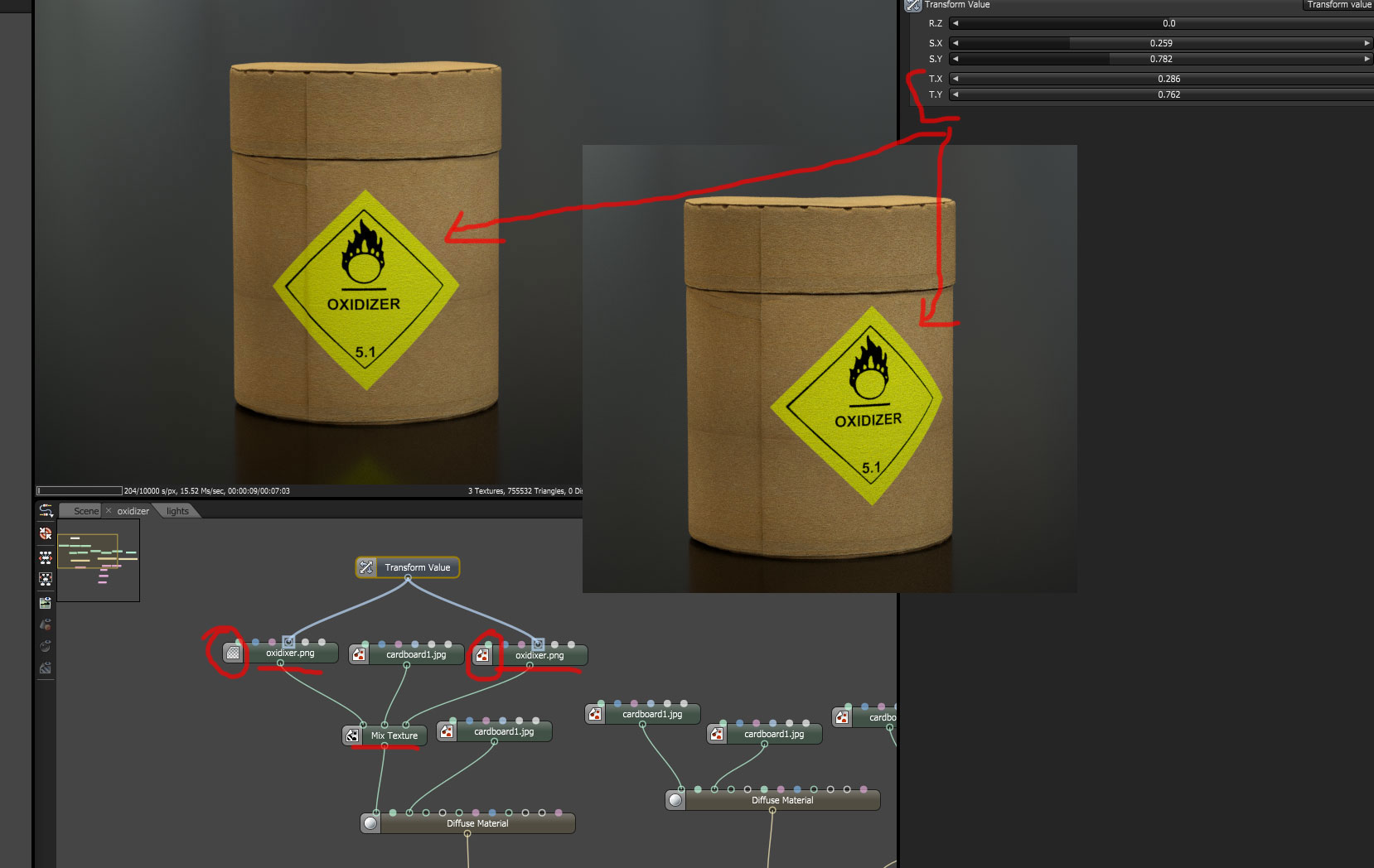

Some time ago I did a scene where I had to move a sticker over a cardboard cylindrical package. Here you go - use mix materials with the alpha image and the rgb image. For details I am uploading orbx - go to oxidizer group and play with transforms.

Use the solution I sent. It should work.

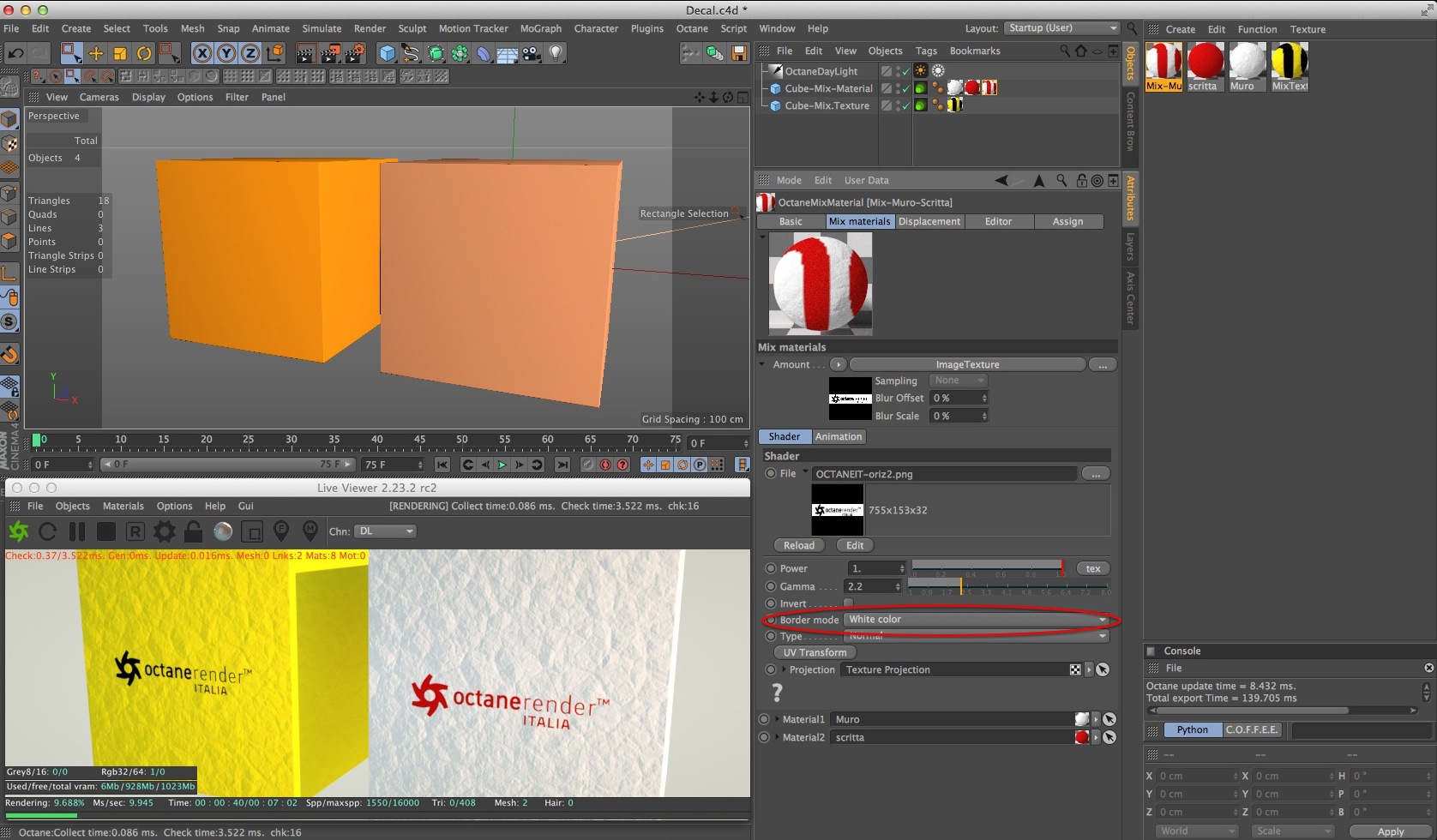

for translating in c4d-octane of what smicha correctly suggest, you have to use a b&w version of your texture in the amount channel and modify the "border mode" option in order to disable the tiling of the texture.
Here is a simple scene in c4d and ocs format ;)
Decal.zip
(95.99 KiB) Downloaded 420 times

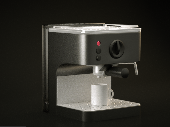

The only issue is that my png is effected by the color of the rgb spectrum, not by its original color ? im trying to put a image insteed for the rgb spectrum, but i dosnt semees to work :) ..
