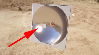

Here is an image to understand the problem..the sun reflection is very big..
there is no way to make it smaller...
here is the example...
I tried turbidity but I loose the correct illumination..
Will try the other feature..

You can make it smaller if you decrease the "Roughness" parameter in the glossy shader.
-Juanjo

Highlight compression reduces it a bit but i loose other kind aspects of the material...
Is this an Octane core provblem or just a little feature missing?
thanks

Thanks Juanjo,
I knew that but i need the material a bit blurred as reflection...
thanks anyhow..
