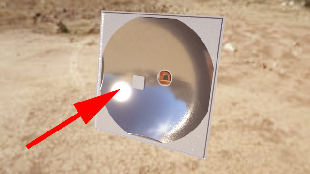

Here is an image to understand the problem..the sun reflection is very big..
there is no way to make it smaller...

here is the example...
I tried turbidity but I loose the correct illumination..

Highlight compression reduces it a bit but i loose other kind aspects of the material...
Is this an Octane core provblem or just a little feature missing?
