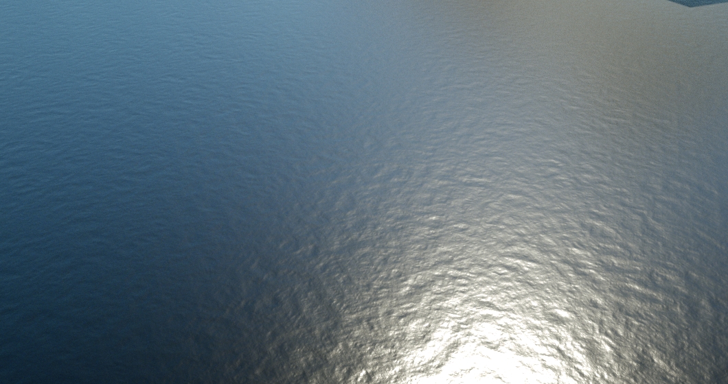

i'm trying to create some water with waves, and i have started with the water that comes from a scene 'oceanwater.max' by karba (i think, i could not find the thread again).
the waves area created using turbulence texture as a bump map.
but how can i create bigger waves? i guess i need to use displacement, insted of bump, but it seems that turbilence texture does effect the displacement map :-/

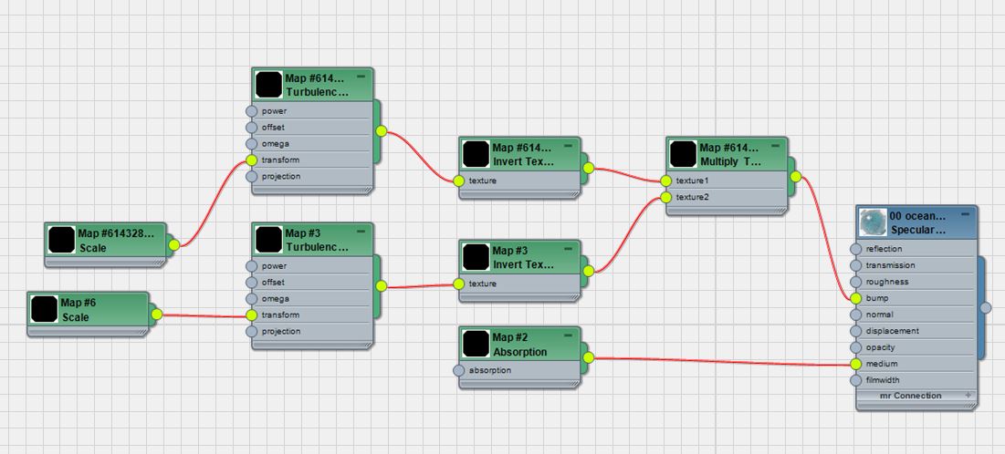

If you plug the turbulence texture into a Multiply node, you can exaggerate the effect with values greater than 1! Try turbulence times 15 8-)

Jorgensen, my suggestion was for just an exaggerated bumpmap. For some reason, displacement maps can only accept bitmaps for now, and not procedural textures. A displacement map will be more realistic but much more difficult to work with and longer to render.

hi probetis
i've tried to add an multiply texture - but i see no effect - am i doing something wrong?
@others
thanks for the input - but i would like to see if i can improve the octane texture before trying plugins :-)
HOME octane standalone v3.07 | octane plugin for sketchup 3.07.0.14 | sketchup pro 2017 17.2.2555 64 bit | windows 10 pro 10.015063 build 15063 | i7-6700k @4.0 GHz | 32gb ram | 2x gtx 1070 | nvidia driver 382.33
