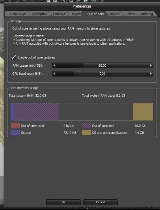

Marcus,
Could you please say something more about out of core textures RAM allocation.
1. When will I see the system RAM used? I just added the 200MB texture to a scene with the 'out of core option' on and 'out of core used' says 0.
2. GPU head room - what exactly it does? For a GTX Titan is it better to set it to 1024?
3. How can I control of how much of vram is taken by textures?
abstrax
Posts: 5516
smicha wrote:Marcus,
When (availableGpuRam - oocHeadroom) is not enough to facilitate a texture on the GPU, it will be stored in host RAM insted. In other words: Only when a device runs out of memory you will see out-of-core memory being used.
That's the amount of space you reserve for other GPU users.
Octane maximizes the amount of memory up to the headroom limit you specify. In general, you want to have the maximum amount of stuff on the GPU since this memory is fast.
