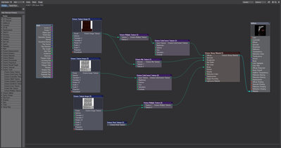

thanks for the work done !!! I would like to ask you a question: I noticed a difference, to get the color in LW I had to connect the color Texture of octanmixtexture (specular), while on octane standalone applies only map gray! what's the problem?

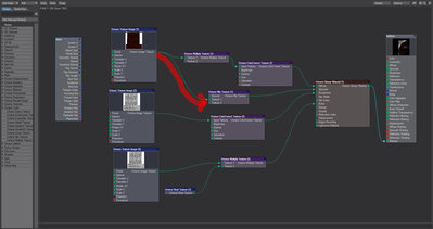

in the attached image I highlighted the problem in red. The connection i made in LW is not required in Octane.
