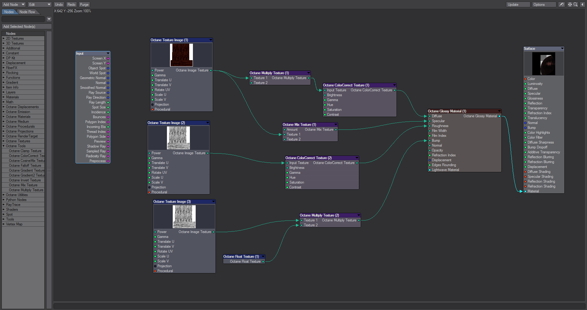

Hello everyone, I'm trying to play a node octane on lightwave. I'm using different textures, but I would get the same behavior! do you think the procedure adopted on LW is correct?

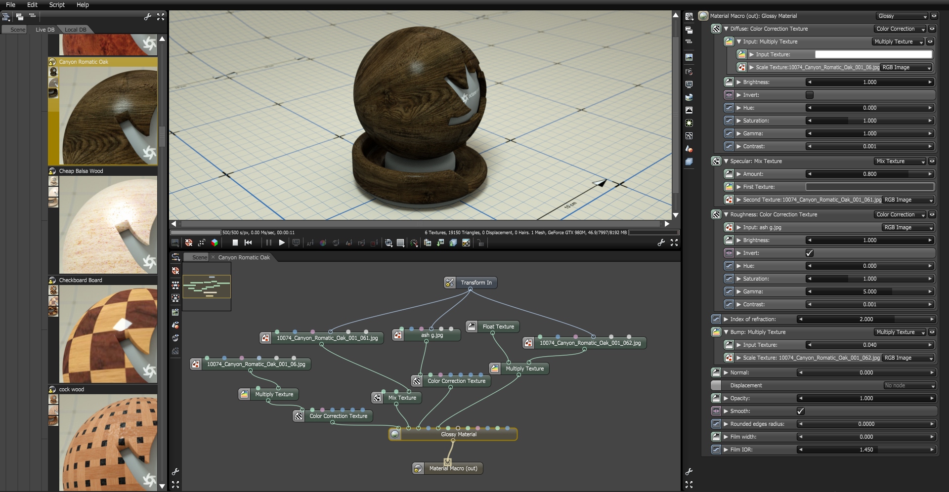

If you copy the nodes/parameters from a material in Standalone you should get the same material in LW.

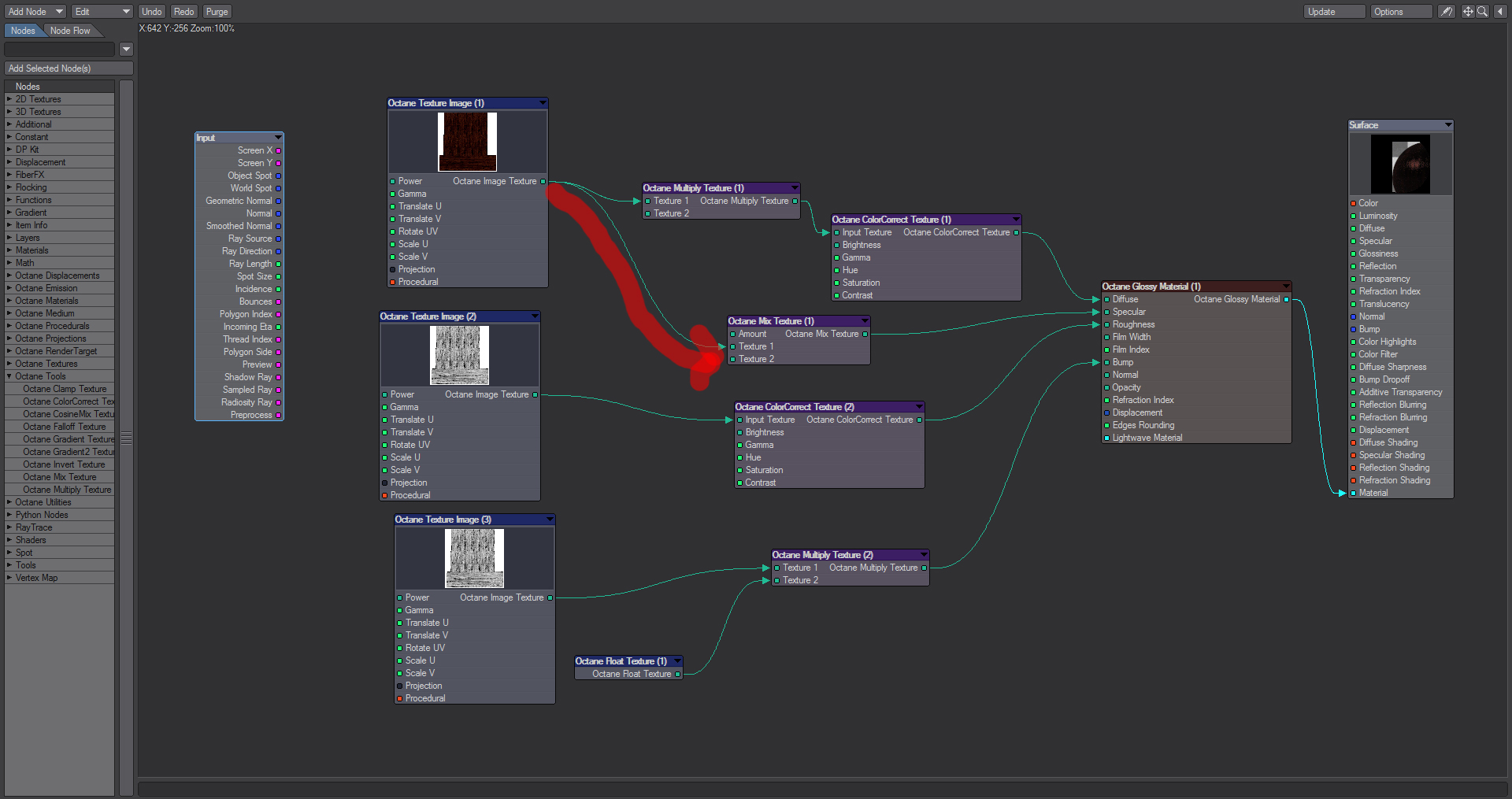

thanks for the work done !!! I would like to ask you a question: I noticed a difference, to get the color in LW I had to connect the color Texture of octanmixtexture (specular), while on octane standalone applies only map gray! what's the problem?
