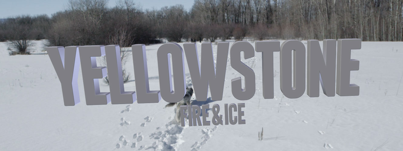

This is the viewport render, which is correct.
Viewport render
Viewport render

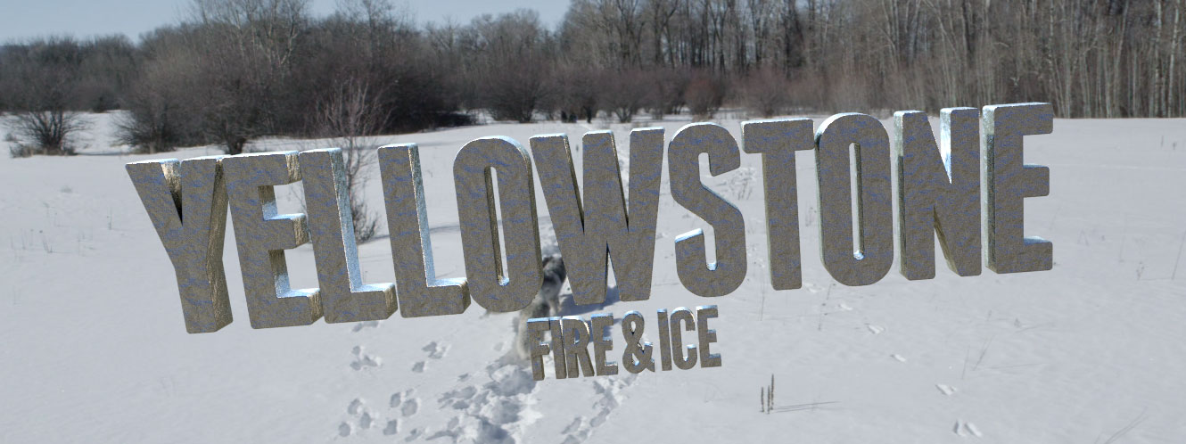

This is the final render, which the camera is rotated about 2.3 degrees.
Final render
Final render

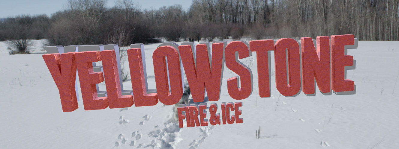

This is a comparison between the two (the red being the final).
Comparison
Comparison
