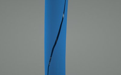

i'm currently working on a customer project. Today i discovered some artifacts on some of the surfaces. The models are simple subpatches with basic octane materials. No maps at all. The artifacts are looking like black lines from a certain distance. If i zoom in i can see through them ... much like clip maps. I tried several things to get rid of this error but nothing helped. (changed environment, surface setting to diffuse etc.,) Any idea what causes this issue? Thanks a lot!

Try adjusting the rayepsilon
Could be a scaling issue
100% tangent surfaces can give problems if the two surfaces
do not have an offset

Changing the ray epsilon form 0.0001 to 0.000001 helped. Indeed i had to do some scaling to fit diffrent objects together in this scene.
Problem solved ... thanks for your help!
