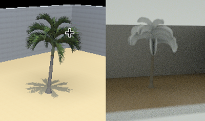

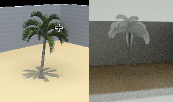

I have an attached file here comparing the textures..
The first photo at the left side is rendered using artlantis..
second at the right side was octane..
If you could help me how to render the "transparency", i think, with octane similar with the first image at the left.
Thanks... :D :D :D :D
This photo compares about leaf texture of a palm...

I'm Talking about the leaf here.. please don't mind the other textures..

Hi, you need a opacity map (black and white) in addition to the diffuse map to get the transparency for the hidden part.

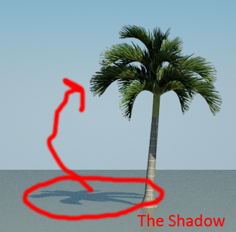

Thank you for the tutorial, it works perfectly but, I have some problem with the shadow. Please see attached file..
Shadow problem...
Shadow problem...
shadow problem.png (210.64 KiB) Viewed 5579 times
enricocerica
Posts: 1012
Joined: Wed Nov 25, 2009 7:32 pm
Yeah, this is a known issue when using sunlight and opacity maps, this will be solved when the "MLT like" will be implemented, for now, you should live with it ;)

Yep, for the moment Octane doesn't transfer the texture's transparency onto the shadows...
We'll have to wait...
