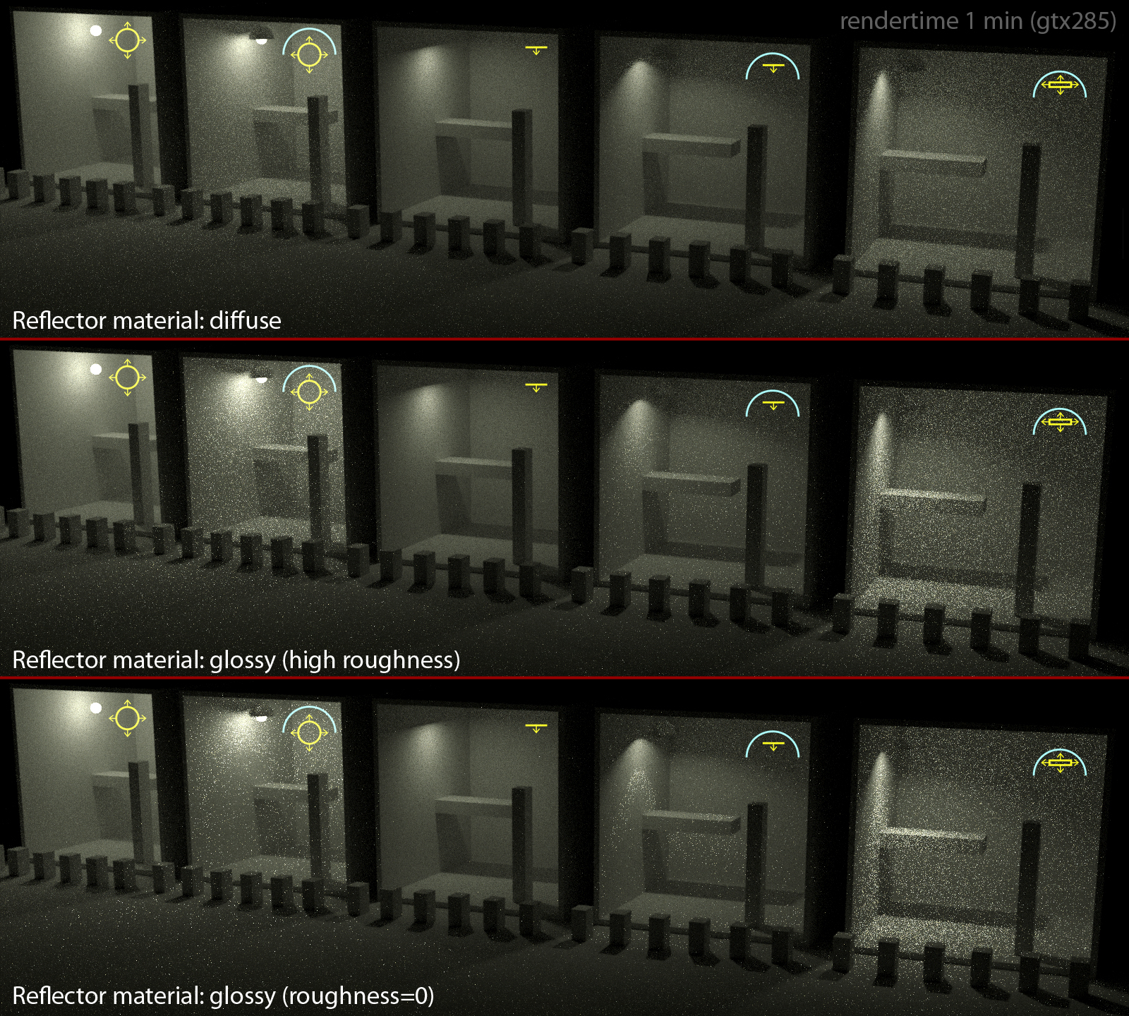

Nothing new - just usual way to keep your images less noisy. It works for any unbiased render
1. Keep emitter away from geometry (if it's possible)
2. It's better to use single side geometry for emitter (normal is pointed to scene)
3. It's better to use diffuse material for reflector

With a little more info on the specific setups other than just icons. Thanks

Carl, its pritty simple.
The blue half circle is a lamp shader. So whenever that is present on the icons it measn there is a shader in play.
The yellow icons should speak for them self, they have clear shapes and arrows.

Carl S. wrote:With a little more info on the specific setups other than just icons. Thanks
Hm, I don't know what else I can tell about lights setup. Arrows show normals. Reflector is two sided geometry. That's all :)

Thanks for your research, This will help with simulating IES light effects in Octane.
Again thanks for sharing and the quick explanation of the icons.
