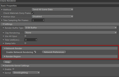

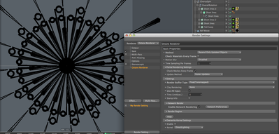

Anyone have experience using network rendering along with the render que function with C4D?
From what I could tell it was not accessing network computers while rendering. Is this a limitation or am I doing something wrong
Thanks for any help or insight

@ abreukers: Yes this is referring to Octanes Network render feature, not C4Ds "Netrender". The other nodes have proper keys and render daemons installed and are confirmed to be working. The network render feature works just fine if I render from within the C4D scene as most probably do. But I very often need to que lots of scenes to render overnight and thought that that C4D render que would be a great way to manage multiple jobs. But it appears that network rendering is broken when trying to do this.
This seems like a simple fix and would help tremendously!
Aoktar do you have any thoughts on the implementation of this?

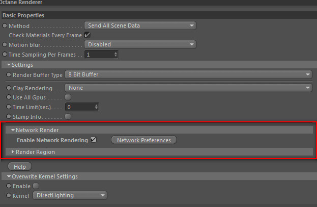

i think you should able to use Octane's netrender with this options.

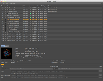

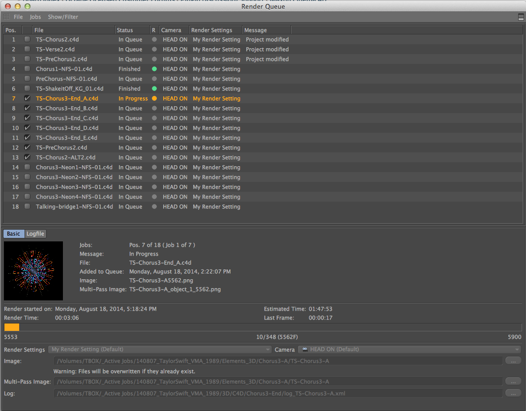

Hi Aoktar,
This was enabled for those scenes. But when using the Que there seemed to be no slaves contributing.
Is this a limitation of Octane render in general?

There is no limitation, maybe a missing functionality. I didn't tested in render queue. what slaves does when you try to render in Picture viewer or Live Viewer?
