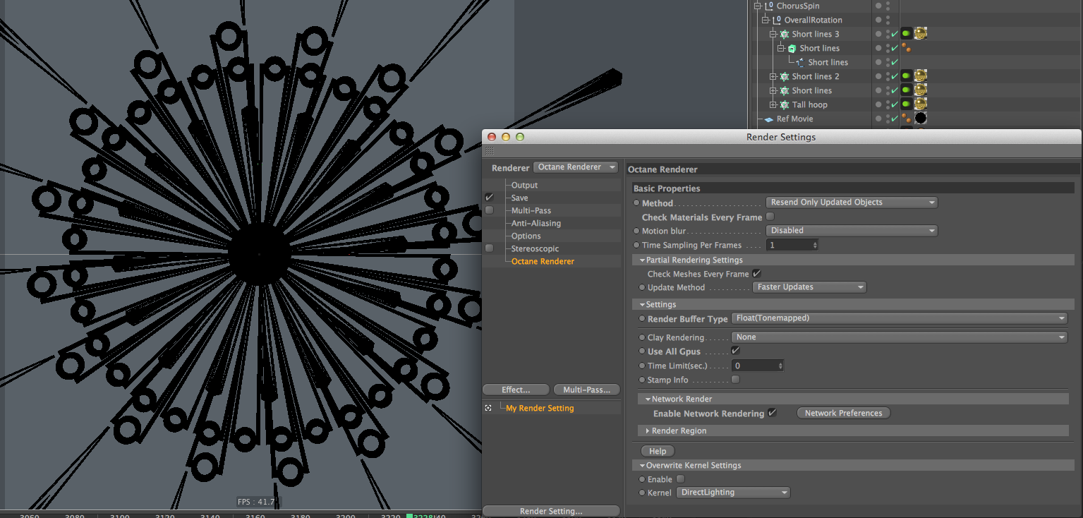

Anyone have experience using network rendering along with the render que function with C4D?
From what I could tell it was not accessing network computers while rendering. Is this a limitation or am I doing something wrong
Thanks for any help or insight
Render Que & netwrok render

@ abreukers: Yes this is referring to Octanes Network render feature, not C4Ds "Netrender". The other nodes have proper keys and render daemons installed and are confirmed to be working. The network render feature works just fine if I render from within the C4D scene as most probably do. But I very often need to que lots of scenes to render overnight and thought that that C4D render que would be a great way to manage multiple jobs. But it appears that network rendering is broken when trying to do this.

There is no limitation, maybe a missing functionality. I didn't tested in render queue. what slaves does when you try to render in Picture viewer or Live Viewer?

I'm using the latest version (2.05) and it all seems to work fine for me. I agree that it is a very important feature.
